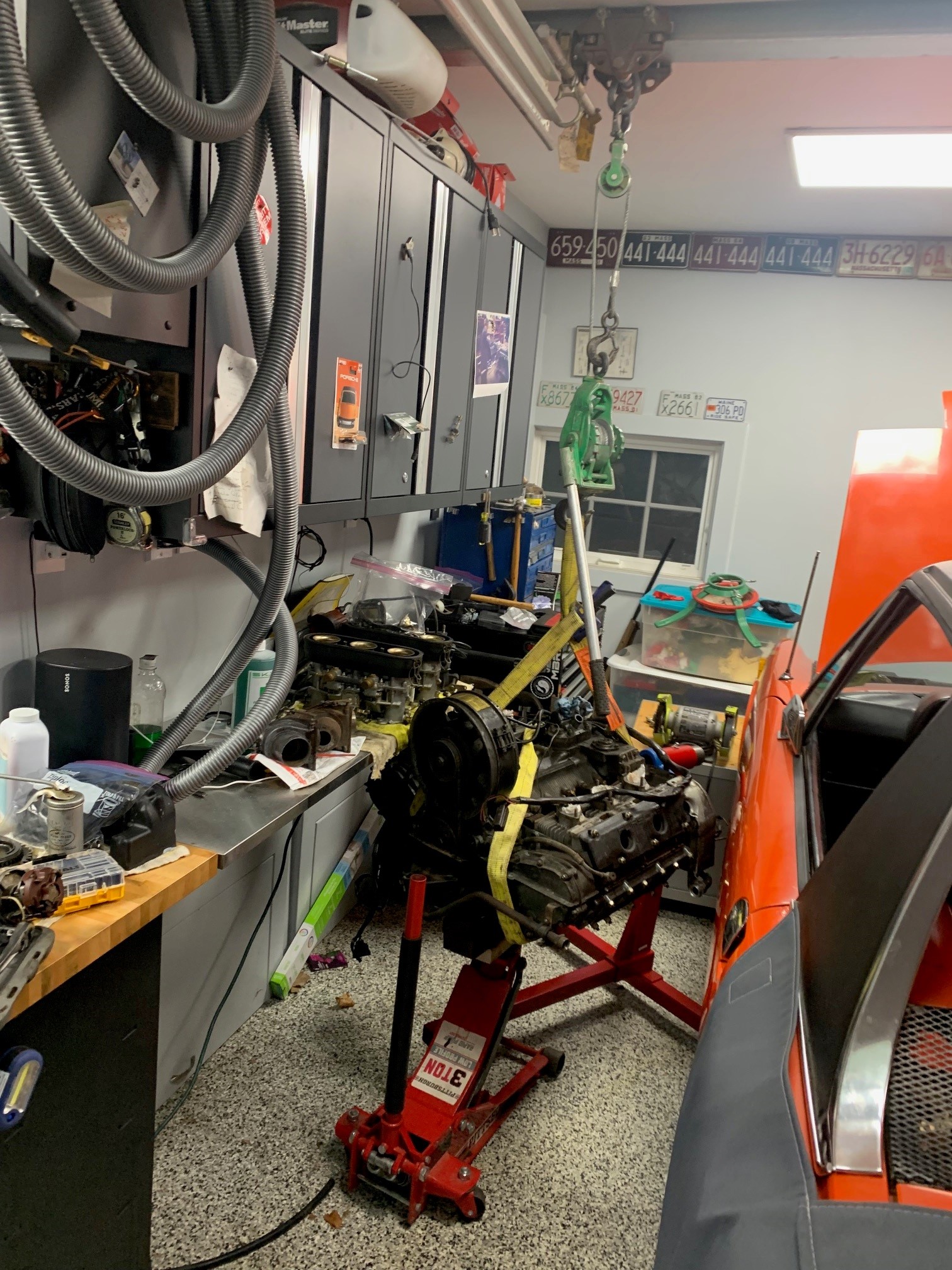

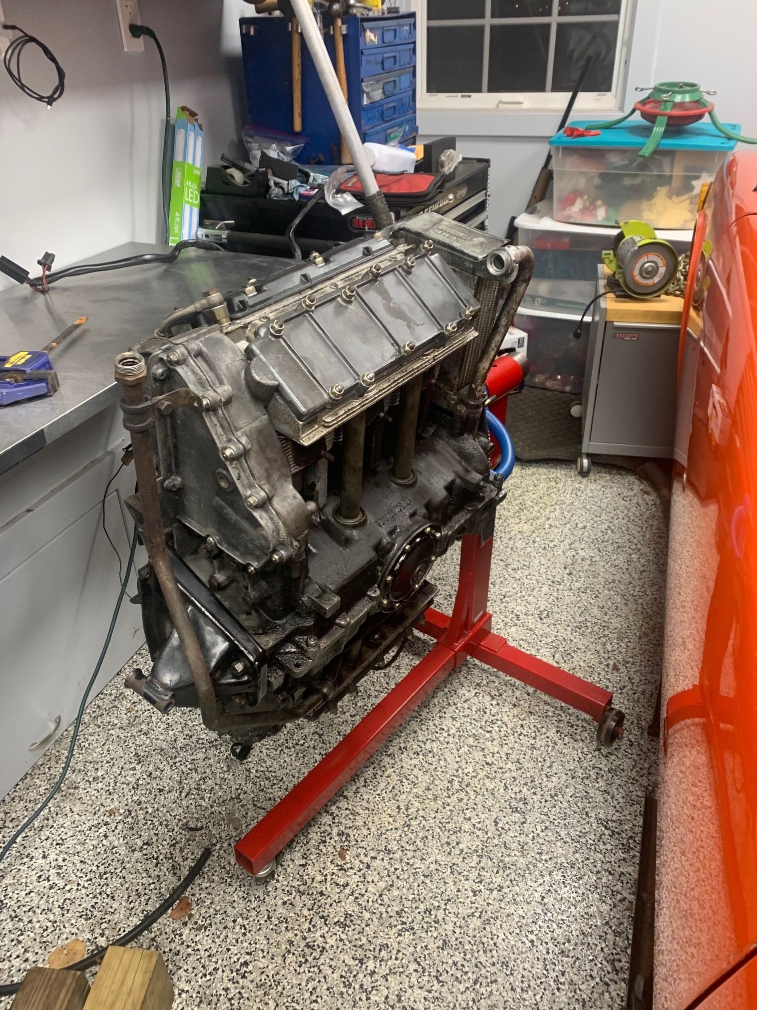

Engine on Stand - Tetris with Blocks lift and patience. Not a one man job!
