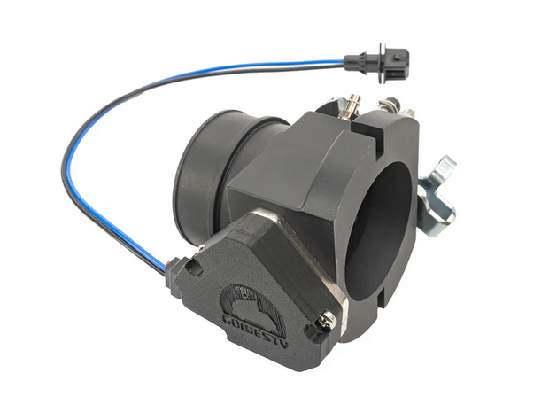

Maybe my next CAD project.
Oooo. That would be awesome. Here is what GoWesty came out with for the Digifant Vanagons. Made from billet aluminum. Grant it our little 914s are slightly different (IMG:style_emoticons/default/wink.gif)
