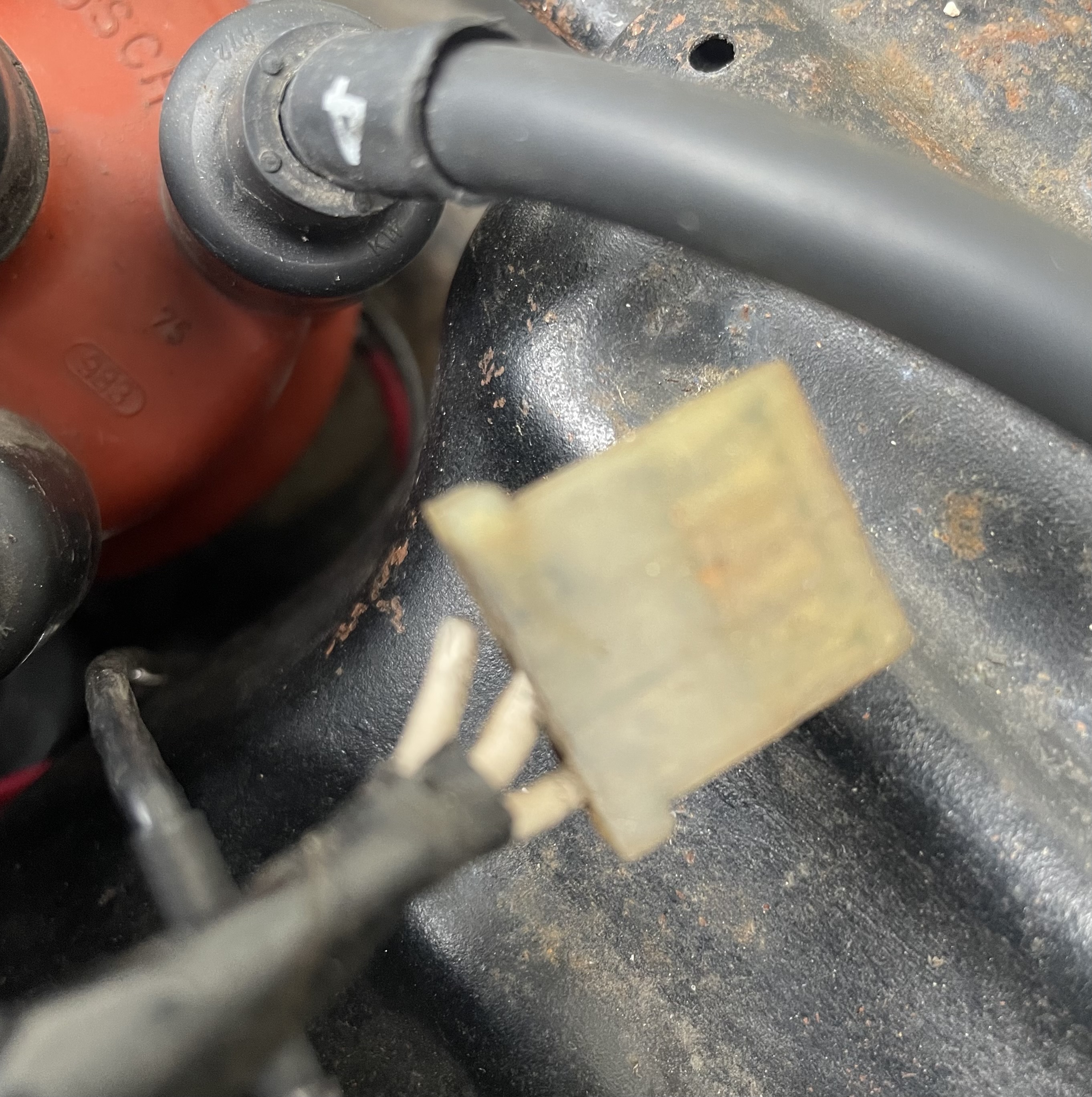

Next I thought I’d test the 3-wire plug on the side of the distributor (to/from the trigger points). Here’s a picture of what I found there.. one wire is broken. I believe this is the ground wire, a guess based on the fact that I could not get either of the plugs at the injectors on the driver’s side to light up with a test light set up.

Literati914   The wires to that plug were all feeling a bit weak...   Mar 6 2025, 06:05 PM
