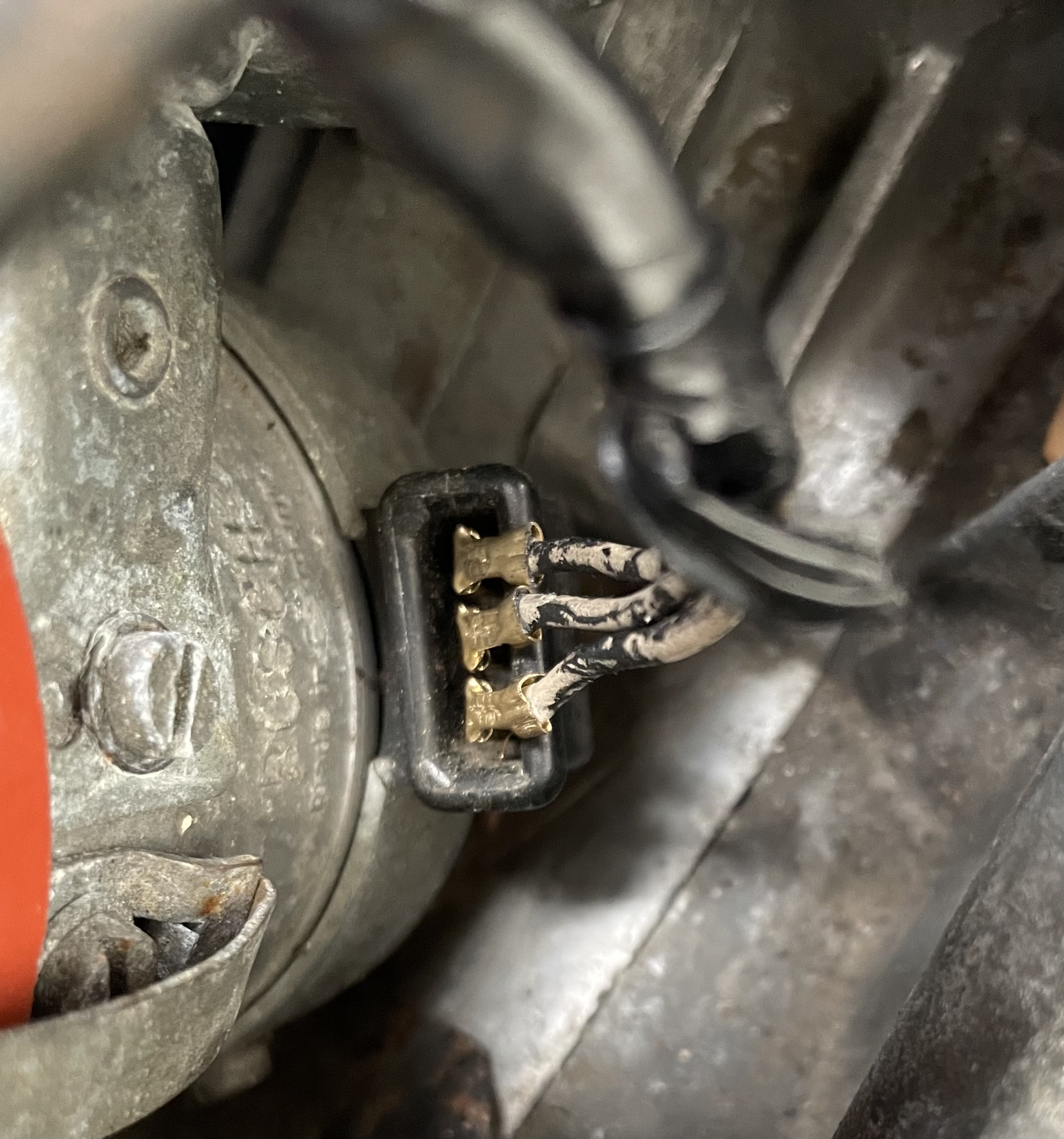

The wires to that plug were all feeling a bit weak, so I cut them (will have to go back and do a proper fix later) and added very small female spades. It’s plugged in and doing nothing (IMG:style_emoticons/default/headbang.gif)
I get no illumination at the test light on any of those three wires when attempting to start the engine. Any ideas on what to check next?
