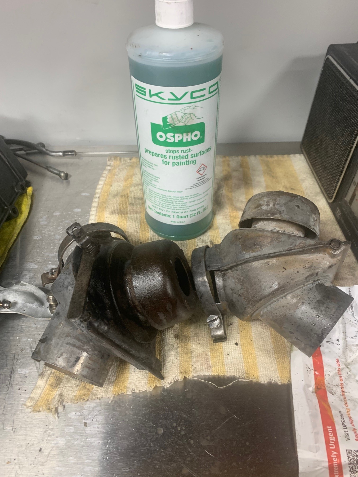

Heat exchangers have no holes in the pipes that I could find, the surrounding tin has been treated with anti-rust leakage - perhaps this was the plan in Stuttgart?

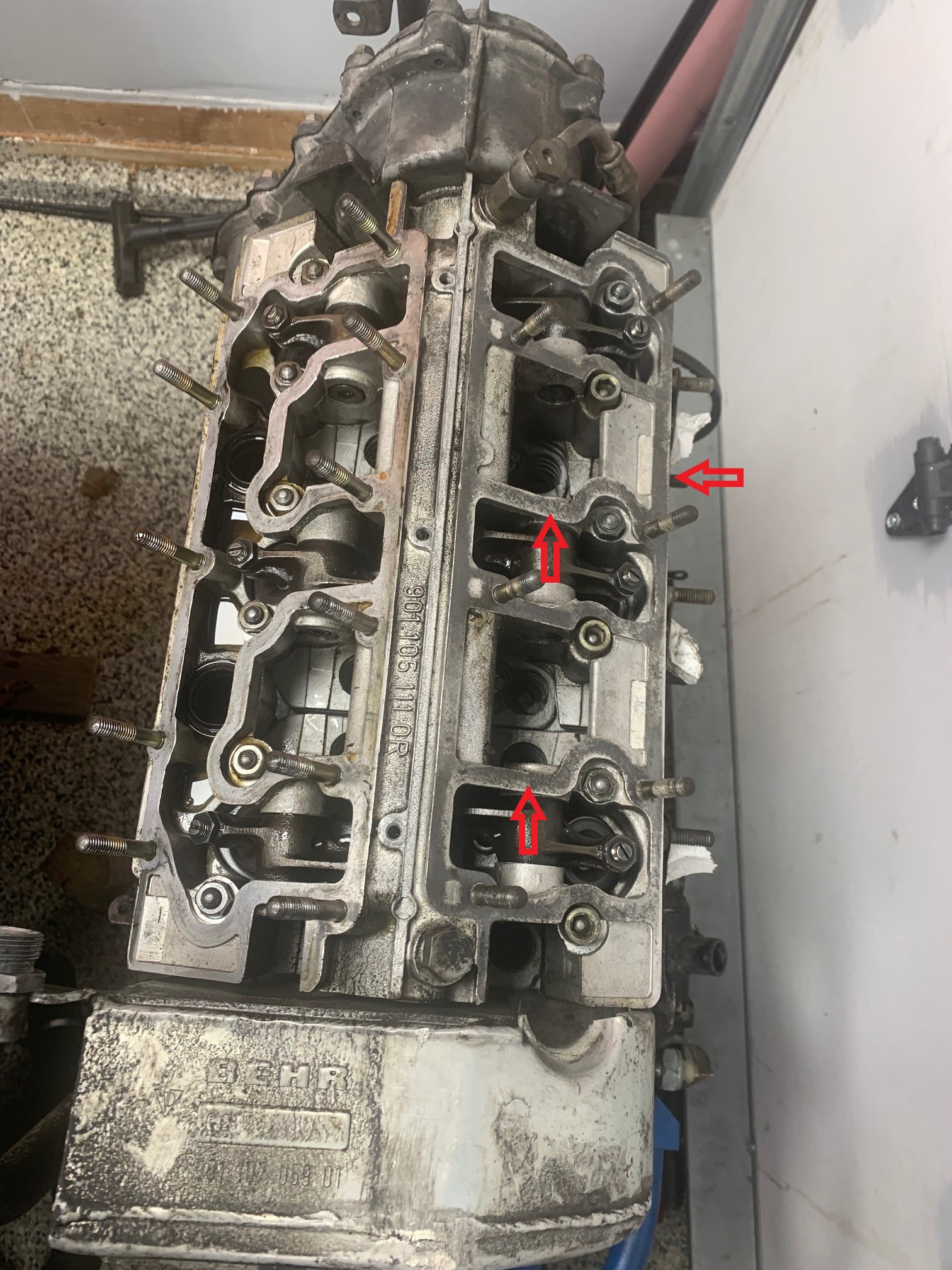

Took the valve covers off, they were close to finger tight - pretty certain that they were not torqued - if they were is the torque setting 'finger-tight'?
Head Stud Nuts all very tight - no broken studs, no leaking at the cylinders at either the head or the case.
The mating points between the covers and the cam housing are very dirty, will try and get them shiny and able to seal.

ctc911ctc   *********UPDATE*********** Drained all of the fl...   Feb 9 2025, 03:17 PM

ctc911ctc   ********UPDATE********* Heater Manifolds and all ...   Mar 5 2025, 01:55 PM
Root_Werks   Lucky enough to also have a good powder coater clo...   Mar 5 2025, 03:03 PM
ctc911ctc   Took the valve covers off, they were close to fing...   Mar 6 2025, 07:33 PM

fixer34   Stock lower valve covers were notorious for warpin...   Mar 10 2025, 08:16 PM
930cabman   Stock lower valve covers were notorious for warpi...   Mar 11 2025, 04:42 PM
ctc911ctc   On my small machinist table they are straight - I ...   Mar 11 2025, 06:36 PM
