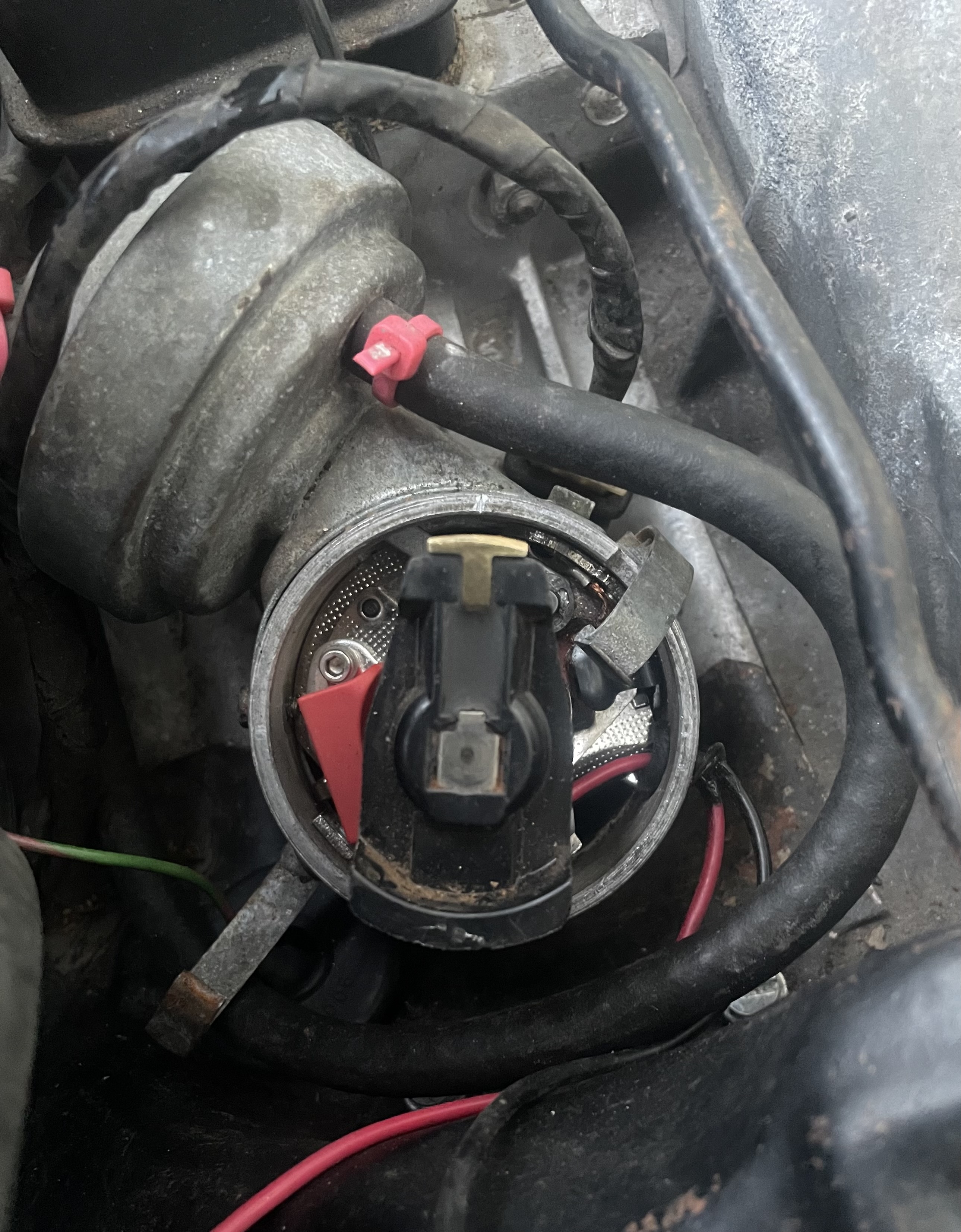

Literati914   I pulled the trigger points but see nothing that l...   Mar 6 2025, 06:57 PM
Literati914   Another view   Mar 6 2025, 06:58 PM
emerygt350   Did you check continuity on the points?   Mar 6 2025, 07:24 PM
