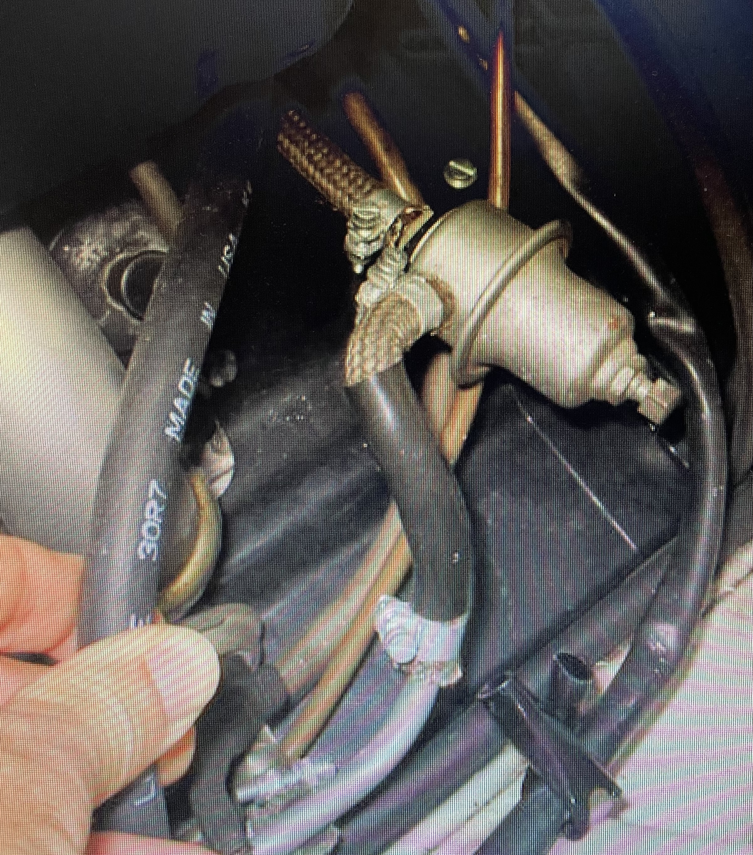

QUOTE(Dave_Darling @ Mar 6 2025, 11:29 PM) *
QUOTE(Literati914 @ Mar 6 2025, 07:54 PM) *
Can't be plumbed backwards because of the way it mounts to the stand/tin.
Hoses can be switched easily. Don't be quite so certain about that... I think one of my early diagrams had the FPR connected backwards, so if you followed it....
--DD
Mine is installed like in the following picture (not my actual car), it would take some trying to get it wrong, I’d think. Maybe if the stand was twisted and the hoses were extra long (IMG:style_emoticons/default/confused24.gif)

Literati914   Update on my ‘no fuel past the FPR’ issue: I b...   Mar 6 2025, 05:59 PM
Superhawk996   Update on my ‘no fuel past the FPR’ issue: I ...   Mar 6 2025, 07:51 PM
emerygt350   Update on my ‘no fuel past the FPR’ issue: I...   Mar 6 2025, 08:13 PM
Spoke   still no fuel getting past the regulator. The r...   Mar 7 2025, 07:35 AM

Dave_Darling   Can't be plumbed backwards because of the way...   Mar 6 2025, 11:29 PM
VaccaRabite   .. I bet it's plumbed backwards And what EC...   Mar 7 2025, 10:49 AM
ctc911ctc   Me too - I had my '73 apart in 1986 for some r...   Mar 7 2025, 01:39 PM
Literati914   Can't be plumbed backwards because of the wa...   Mar 7 2025, 12:04 AM
Literati914   still no fuel getting past the regulator. The ...   Mar 7 2025, 08:29 AM
emerygt350   People manage to route it backwards where the pump...   Mar 7 2025, 09:28 AM

Literati914   Quick update - after testing pressure at the pump ...   Mar 20 2025, 06:26 PM
emerygt350   Quick update - after testing pressure at the pump...   Mar 21 2025, 07:27 AM
Superhawk996   Holy cow, varnish, trash? Wow, that is a new on...   Mar 21 2025, 08:38 AM
Literati914   [Holy cow, varnish, trash? ..some of that tr...   Mar 21 2025, 09:23 AM
emerygt350   [Holy cow, varnish, trash? ..some of that t...   Mar 21 2025, 10:00 AM
Literati914   I installed my replacement engine side hard lines ...   Mar 23 2025, 03:58 PM
