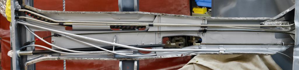

Here's a view of the tunnel from the bottom with no floor pans:
This is an early car with a side shift conversion, stainless fuel lines, and the 914/6 hand throttle. The speedometer, throttle, and heater cables have not been installed.
I'll be adding a few more photos, but I'm putting these up with high resolution and only get one per post.

Another view:

NARP74   If only all that was accessible so you didn't ...   Mar 7 2025, 12:48 PM

zoomCat   This shows the clearance for the shift rod through...   Mar 7 2025, 01:01 PM

zoomCat   The small brake line at the back is a bit convolut...   Mar 7 2025, 01:17 PM
zoomCat   Another angle on the brake line:   Mar 7 2025, 01:18 PM
zoomCat   And the brake union, normally accessible from the ...   Mar 7 2025, 01:27 PM

ctc911ctc   Really like the rubber bumpers on the stainless fu...   Mar 7 2025, 01:33 PM
zoomCat   I took a bunch of pictures from different angles, ...   Mar 7 2025, 01:37 PM
