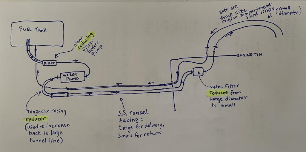

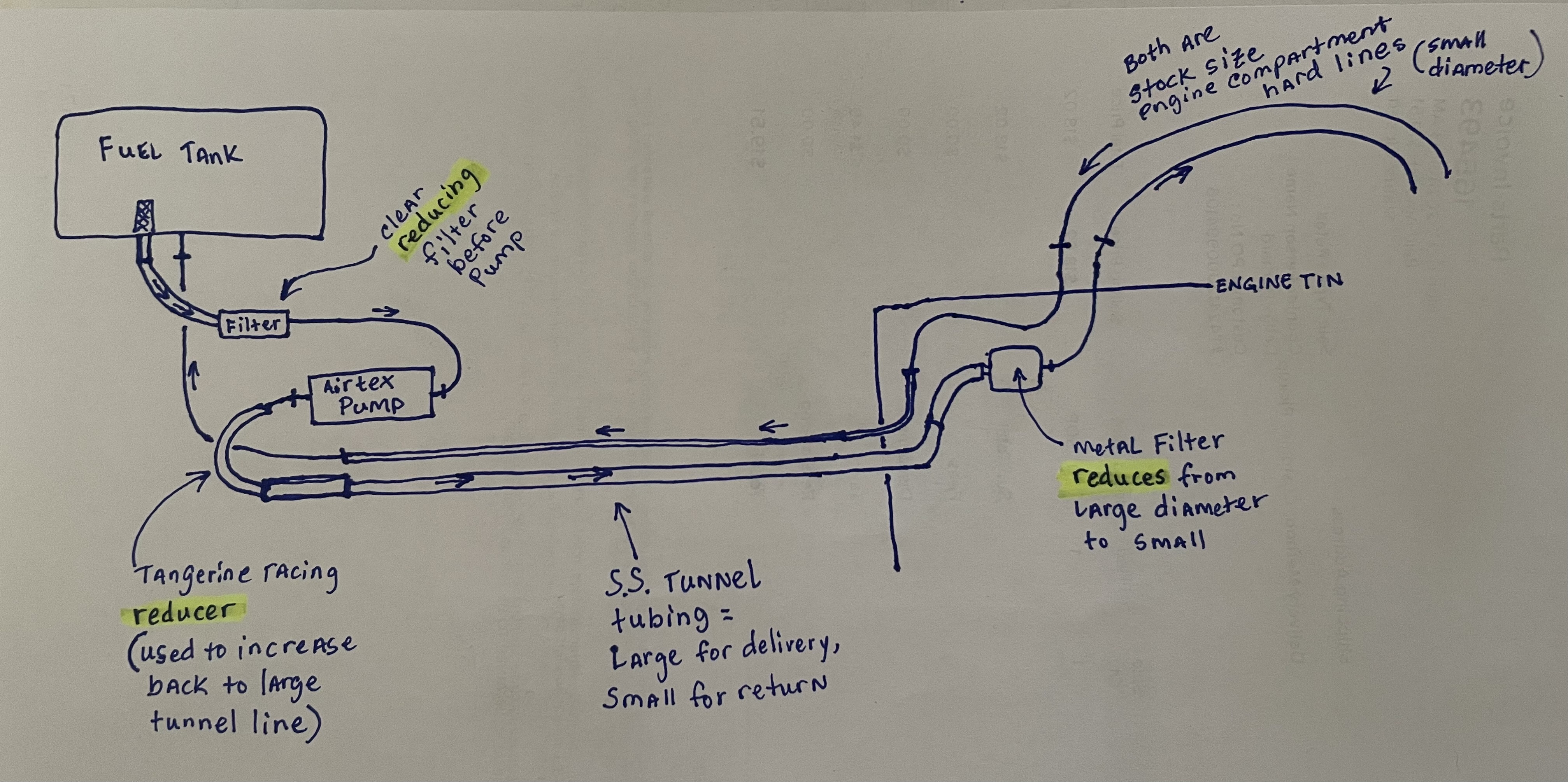

My fuel routing is less than ideal because I have 2 separate reducing points as well as an “increase” area too, believe it or not. The reason for this? I’lll try to explain… it’s an early car, so has 1 large and 1 small diameter tubing in the tunnel (they match the nipples from the tank). The Airtex FP has a small input size, so I used a reducing filter before it to get me there… then the line has to increase again to feed the large tunnel tubing (Tangerine Racing 180 degree fitting).. then it has to reduce again for the fuel rails (metal reducing filter).
I was just trying to complete the routing. I didn’t think that would create a severe drop in pressure but if you guys figure that’s my FPR issue, let me know and shoot me some ideas on the easiest way to change it for the better.
Here’s a quick drawing of my routing :
