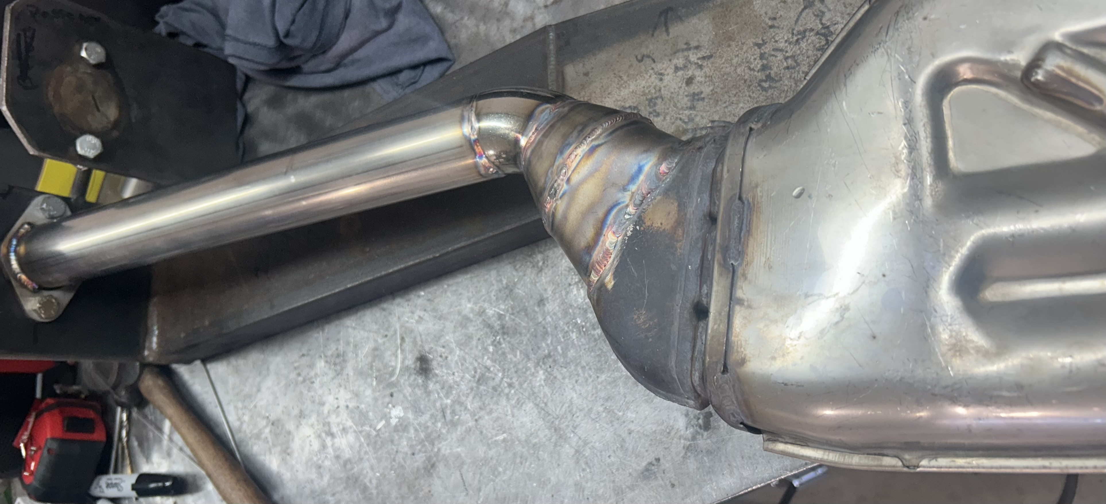

I have been dragging my feet doing these but got a good start this morning. This is a hard process to quote that’s for sure as it is straight up custom. I run this set up on my hot 2.4 with 1.5” sleeves and they work really well. A good solution all the way up to 3.6Attached Image

Attached Image figured out how to make Gillett heat exchangers to work.

Steve   Awesome that you are doing this, but is it less wo...   Nov 27 2024, 08:48 AM
mb911   Awesome that you are doing this, but is it less w...   Nov 27 2024, 09:02 AM
tygaboy   I'll be helping @napasteve Steve with his 3....   Nov 27 2024, 09:25 AM
mb911   I'll be helping [b]@[url=http://www.914world...   Nov 27 2024, 09:28 AM
mepstein   “This is a hard process to quote that’s for su...   Nov 27 2024, 09:34 AM
mb911   “This is a hard process to quote that’s for s...   Nov 27 2024, 10:03 AM
worn   “This is a hard process to quote that’s for ...   Nov 27 2024, 04:47 PM
mb911   [quote name='mb911' post='3179134' date='Nov 27 2...   Nov 27 2024, 05:49 PM

ClayPerrine   Ben, How do you deal with having to flip the flang...   Nov 29 2024, 06:30 AM
mb911   Ben, How do you deal with having to flip the flan...   Nov 29 2024, 07:43 AM
mb911   Ben, How do you deal with having to flip the flan...   Nov 29 2024, 02:21 PM
ClayPerrine   [quote name='ClayPerrine' post='3179385' date='No...   Nov 29 2024, 04:01 PM
mb911   [quote name='ClayPerrine' post='3179385' date='N...   Nov 29 2024, 06:54 PM
