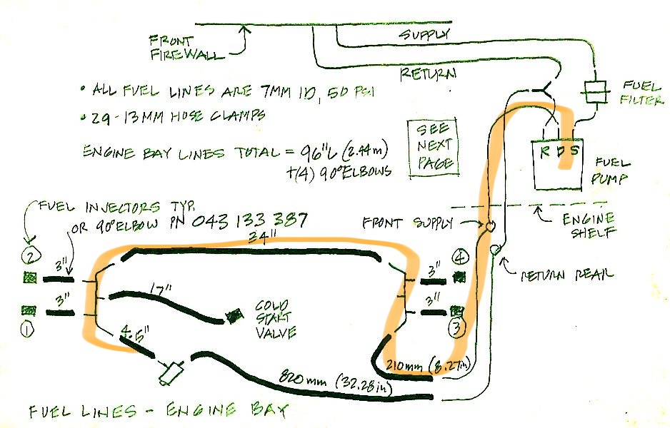

Just going to post this so we have common points of reference. Realize you have a twin port pump and it’s located at front. Supply line highlighted.
Let’s see what pressures look like when you get a gauge on it.

Literati914   So much good info, I appreciate it. Maybe I have...   Mar 9 2025, 12:48 AM
Superhawk996   Just going to post this so we have common points o...   Mar 9 2025, 01:32 AM

Literati914   Quick update - after testing pressure at the pump ...   Mar 20 2025, 06:26 PM
emerygt350   Quick update - after testing pressure at the pump...   Mar 21 2025, 07:27 AM
Superhawk996   Holy cow, varnish, trash? Wow, that is a new on...   Mar 21 2025, 08:38 AM
Literati914   [Holy cow, varnish, trash? ..some of that tr...   Mar 21 2025, 09:23 AM
emerygt350   [Holy cow, varnish, trash? ..some of that t...   Mar 21 2025, 10:00 AM
Literati914   I installed my replacement engine side hard lines ...   Mar 23 2025, 03:58 PM
