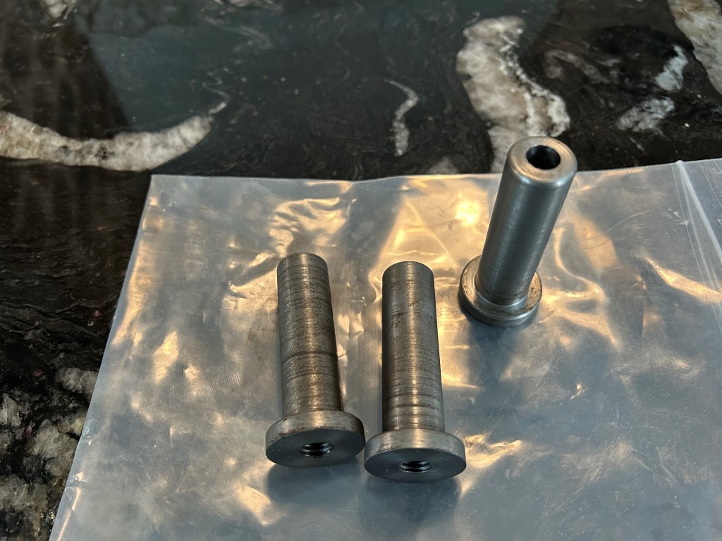

Replacement bobbins already delivered. Will work on getting the ones to replace out of the car this week end and then find a good welder to get the new ones welded in place.

PaIsa   Replacement bobbins already delivered. Will work ...   Mar 10 2025, 10:37 AM
