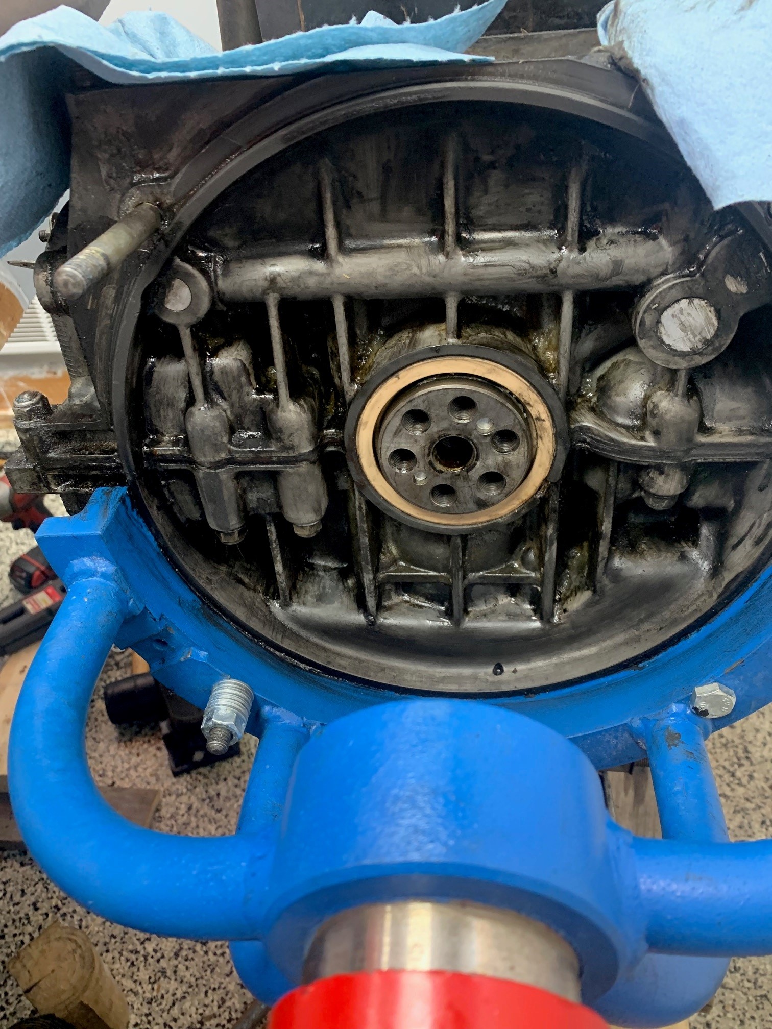

Still cleaning the engine - took off the flywheel and all of the crevases were filled with a gritty oily grime, this is mostly cleaned, I see no cracks or other points of leakage, most likely is from the gasket

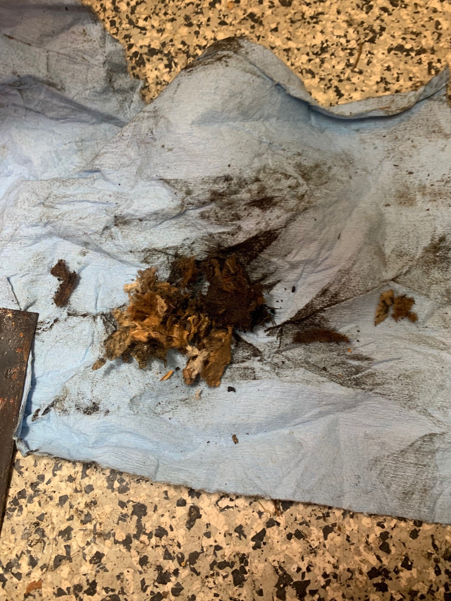

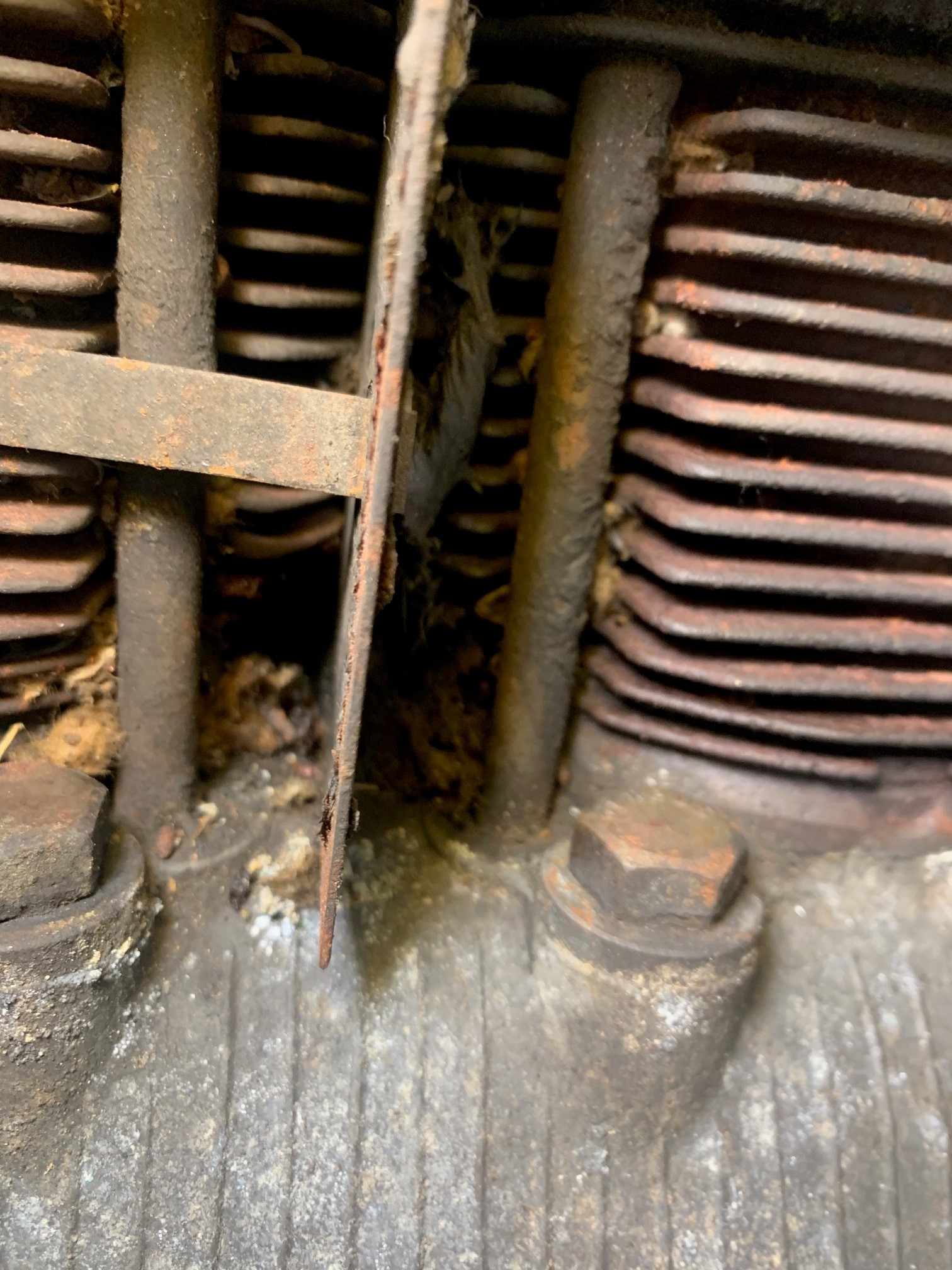

Spent a few hours cleaning all of the fins, lots of mouse parts and their house remnants were found (IMG:style_emoticons/default/dry.gif)
(IMG:style_emoticons/default/barf.gif)
