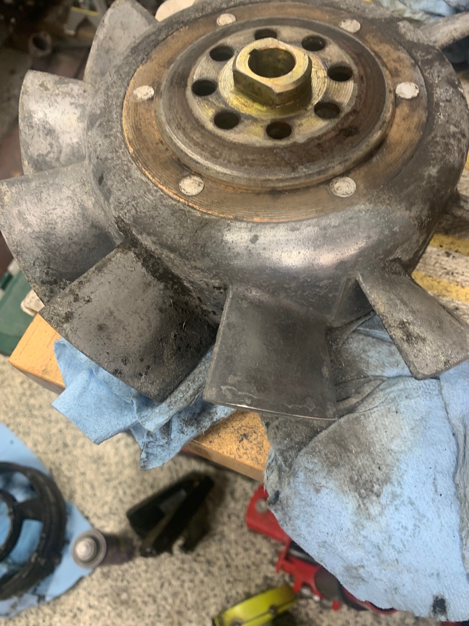

I got the fan out and it now looks like this:
I plan on having it vapro blasted, seems that the stuff I have been using (came with the ultrasonic cleaning machine) is salt based - perhaps that is all of the white crust.....sigh......
NOTE: One blade is cleaner, spent 20 minutes on it with steel wool, hence my decision to vapor blast
