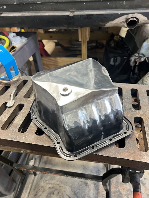

Well, a year went by since my last post… good thing I don’t have a deadline for this build! Over the last couple of months, I have been able to spend some more time on the car. Here are some progress pictures.

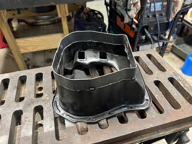

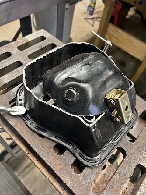

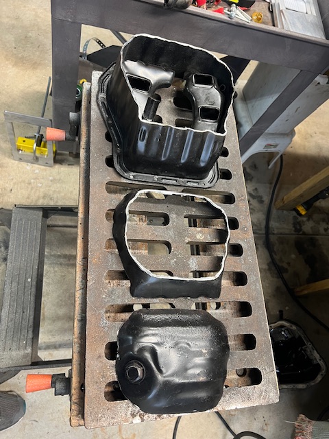

To get back into things and to test out my new welder, I thought I’d try making a shortened oil pan. I know these can be bought, but I wanted the exercise and I knew a homemade version would be cheaper. Started by cutting up a spare to see how things looked.Attached Image
First I thought I’d try to keep the original bottom section with the drain plug, but it seemed like it was going to be too hard to join the parts back together and get it to look good like this.
So I decided I would make a new, flatter bottom and I cut up the brand new pan I bought from Amazon. I made my own transition section to retain some of the volume. I also shortened the pick-up tube.
Then, after a lot of forming, welding, grinding, checking for leaks, re-welding and more grinding, I ended up with this. I bought a low profile drain plug because the stock plug stuck down farther than I wanted. I measured the volume of the finished product and it’s about 1/2 quart less than the stock pan. That doesn’t seem like a huge problem to me, but I’m willing to listen to opinions from others.
