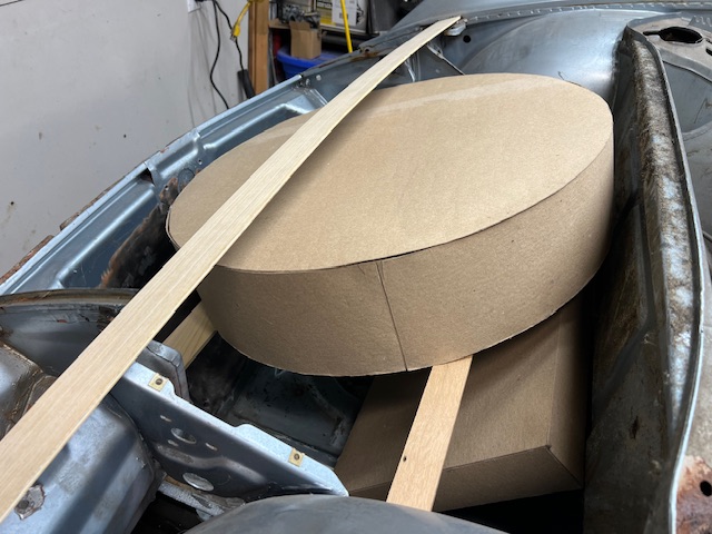

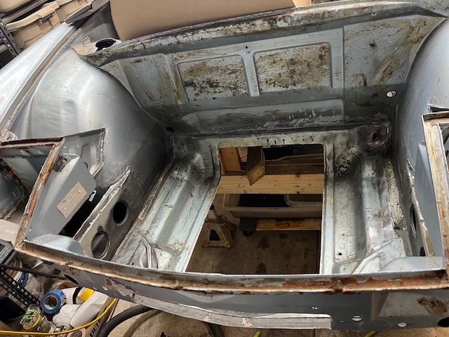

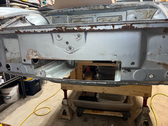

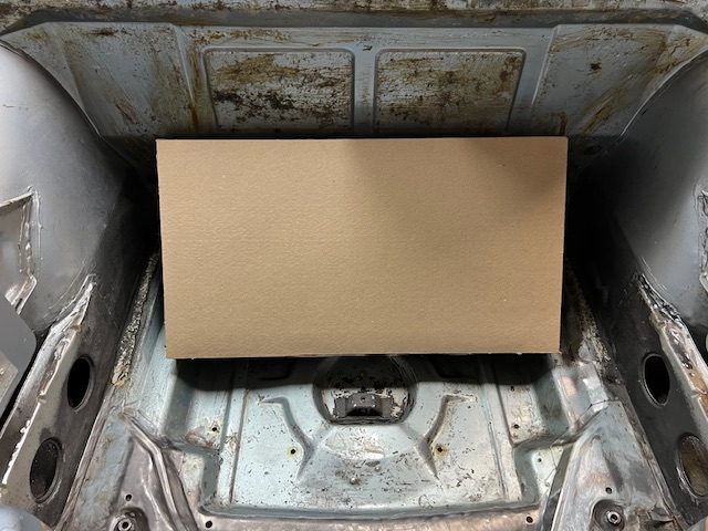

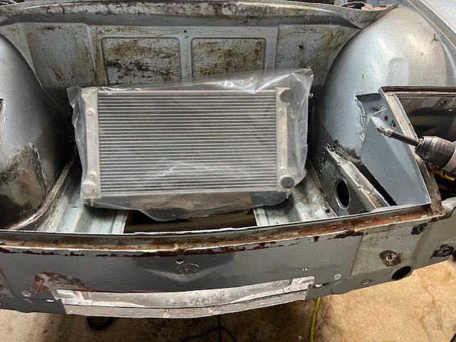

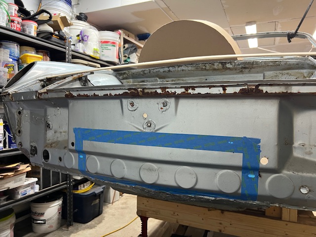

Next up, I thought I’d start figuring out radiator mounting. Originally, I was going to use a Mishimoto radiator and fans for a Celica like others have done, but I really wanted to be able to keep a spare tire in the frunk and I don’t like the idea of the collapsible spares. So, I bought a smaller, Scirocco-style radiator from Amazon. There are lots of variants to choose from and I ended up going with one that had mounting points for fans on both sides of the radiator. Before I started cutting big holes in the frunk, I made some cardboard mockups of the spare tire and the radiator to see what this might look like.
Satisfied that there was a way to make this all work, I went all in and cut some holes.

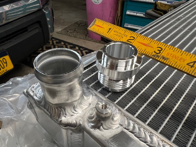

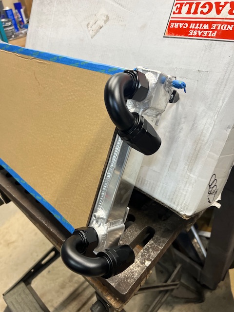

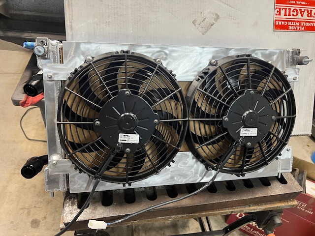

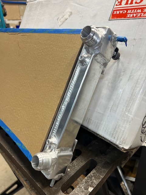

My plan is to run both cooling hoses up the drivers side longitudinal. This portion of the chassis is still wide open from the rust repair I have yet to button up. With this plan, I wanted to keep the radiator inlet/outlet on the drivers side. But with the radiator configurations I could find, it was going to be tricky to route the hoses this way without a lot of clunky hose bends and fittings. So, I cut the hose fittings off of the radiator and had a welder buddy of mine weld some AN16 bungs in place. This gives me lots of options for AN elbow fittings, etc.

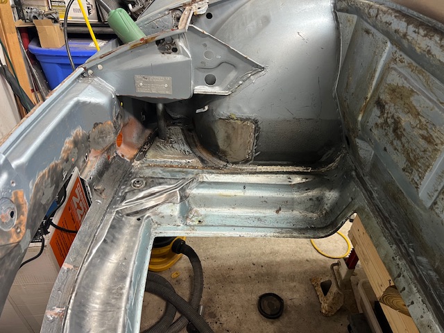

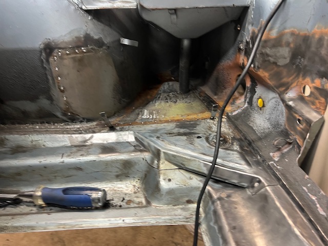

While working in the frunk, I realized that there was some mediocre repair to fix some front end collision damage sometime in the past. The chassis supports near the headlight buckets were not straightened very well and were poorly re-attached to the front cross piece. Also there was a lot of Zeibart coating under the headlight buckets that was bugging me, so I decided to pull out the chassis supports, straighten them and clean under the headlight buckets.

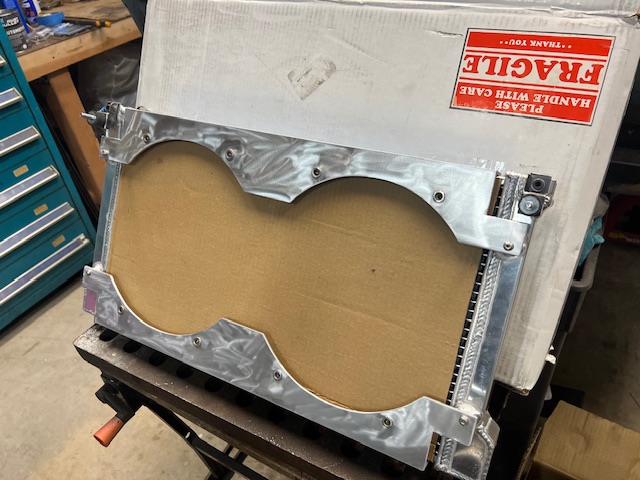

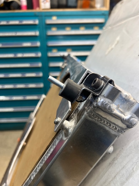

I ordered some Spal fans, some AN hose fittings and I made some parts to mount the radiator and mount the fans.
