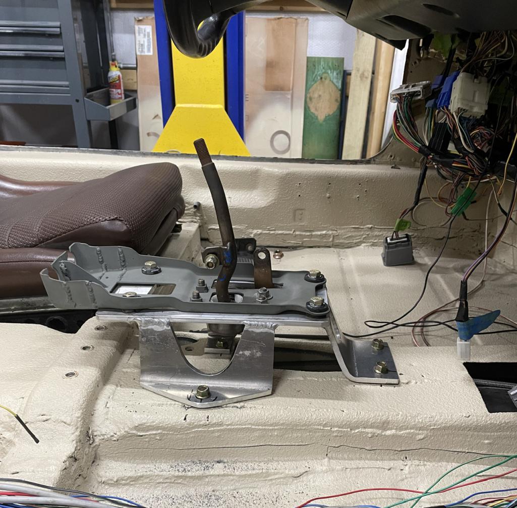

My crazy, home-built cable shift linkage:Attached Image
My home-built engine cradle: Attached Image
Shifter from a boxter (slightly modified): Attached Image

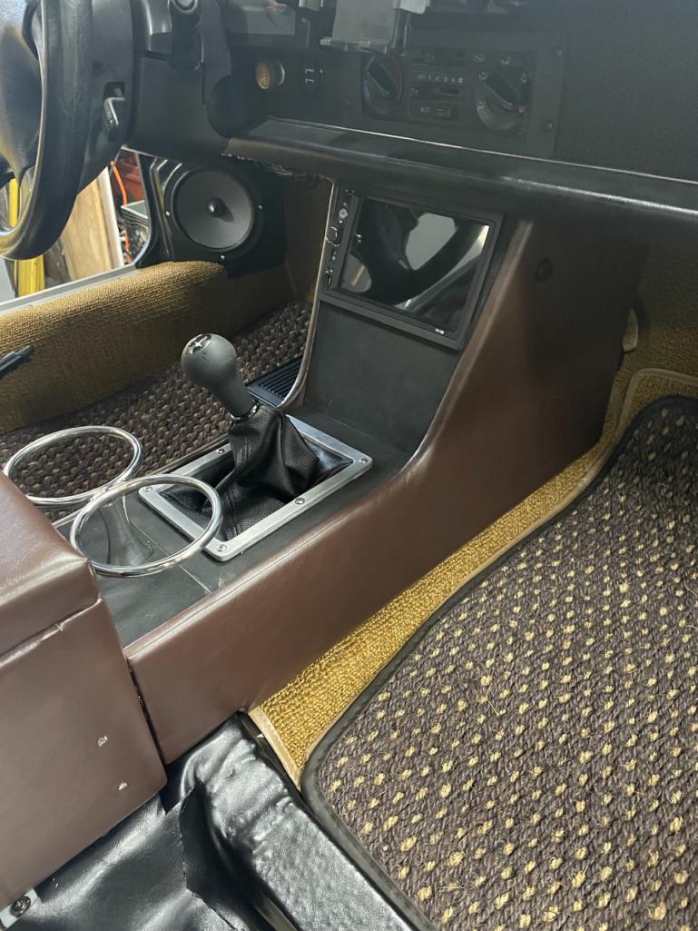

I hid mine under a custom center console. Mine is the MR2 shifter but similar height with the mounting bracket.
