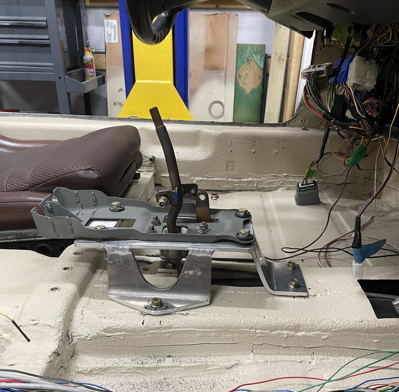

My crazy, home-built cable shift linkage:Attached Image

Shifter from a boxter (slightly modified): Attached Image

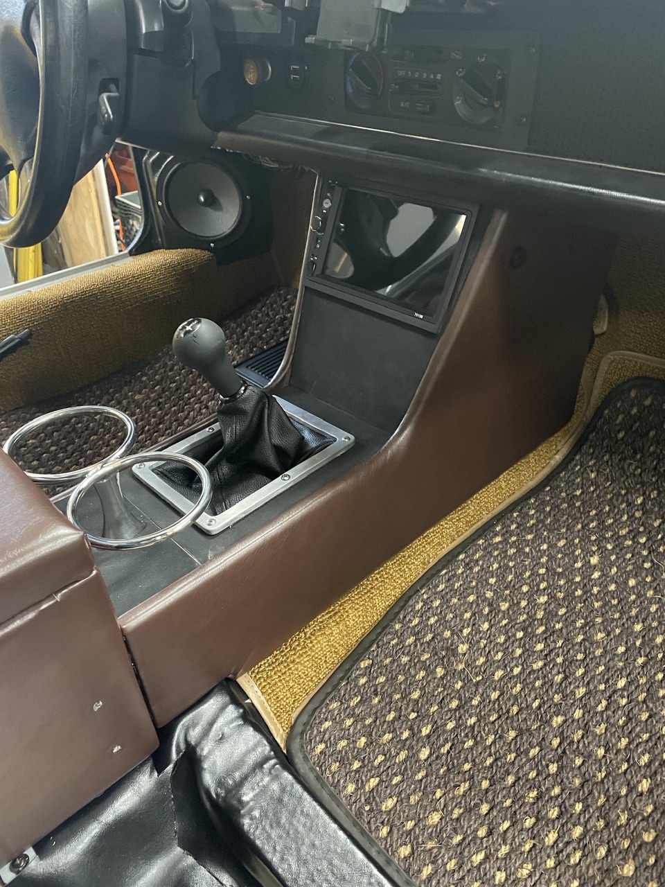

I hid mine under a custom center console. Mine is the MR2 shifter but similar height with the mounting bracket.

QUOTE(East coaster @ Mar 14 2025, 11:18 AM) *
Yep. I’m hoping to do something like that. Love your whole build, btw!
