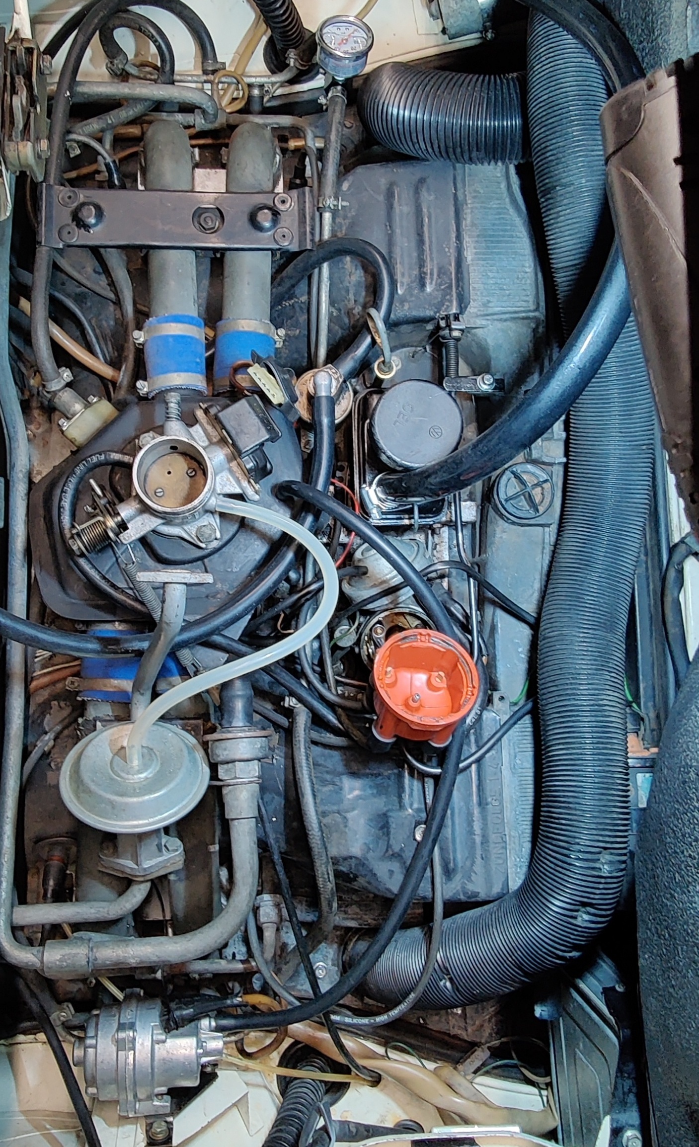

2400-2600 rpm stumble with partial throttle, stumble goes away under full throttle. Runs smooth at all other RPMs. Pulled the plugs, a little lean maybe?
Edit 3-17-25 I found a possible cause; worn distributor bushings causing a variation in the points gap.

I had another thought as well... Does your car have the EGR setup? If I remember correctly that would be plumbed to ported vacuum and kicks on during cruise under light throttle. You should make sure that (if you have it) and the retard are hooked up correctly. If they are, I would disconnect them and see if the problem persists.
On my test drive, I didn't have the air cleaner box installed so the engine wouldn't have been receiving the exhaust gas and it still had the issue. I haven't tried driving without the retard vacuum hose removed yet. I may still need to test the tps because the car doesn't run worse without it except for idle.
