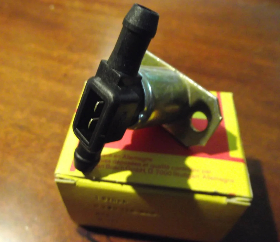

This really sounds like the routing is not correct. You should be going from pump to rails to regulator to tank return. The csv comes off the driver side rail as a side circuit. Is that what yours is doing? Pictures?

QUOTE(emerygt350 @ Mar 19 2025, 10:22 AM) *
Nope.
1.7L cold start injector is like a T and has a slightly different fuel flow and routing vs 2.0l. It could be plumbed like a 2.0l (assuming a single inlet 2.0L CSV fits a 1.7L plenum??? Based on pic I think the flange is different???) but would result in more hose running around the engine bay to the frontside of the 1.7L plenum.
I posted the 2.0L fuel line diagram because I couldn’t find one for a 1.7l. Wanted as a graphic aid to ensure that the fuel pressure regulator was at the end of the fuel circuit and so we would have common reference points. I apologize for any confusion I caused by posting the 2.0L fuel line diagram.

Superhawk996   So - I'm thinking the CSV could be the only...   Mar 19 2025, 08:36 AM
emerygt350   This really sounds like the routing is not correct...   Mar 19 2025, 08:22 AM
Superhawk996   This really sounds like the routing is not correc...   Mar 19 2025, 08:39 AM
