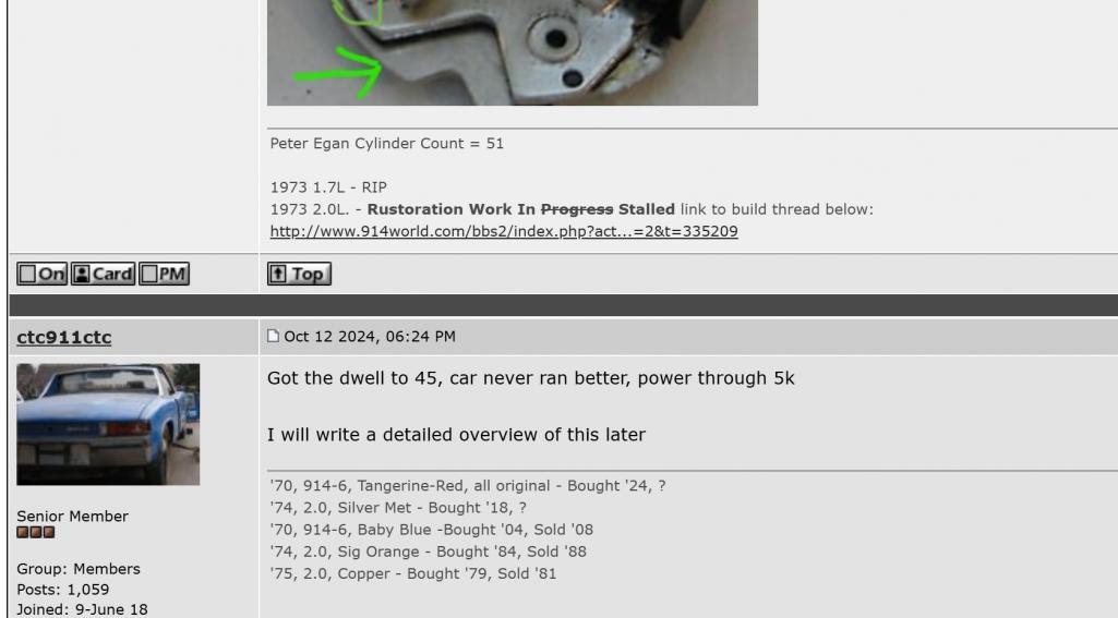

I wouldn't ignore the dwell. Could be a real low-cost easy win. Maybe not, but worth doing.
http://www.914world.com/bbs2/index.php?sho...72087&st=20
Maybe you could find one to borrow. Local mom and pop car repair?
