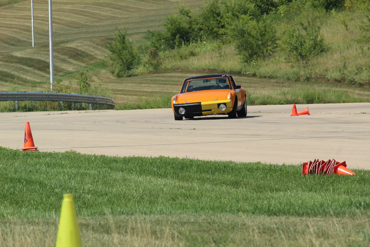

any situation then the 140 rear and 19 mm front is a capable setup.A 19mm and 17mm sway bars work well with that. If you prefer to motor under more comfortable conditions Root Werks setup sounds nice.
Ive go what Shivers mentions. works well at auto-cross/hill climbs but is still street compliant. Love it. MarkAttached Image
