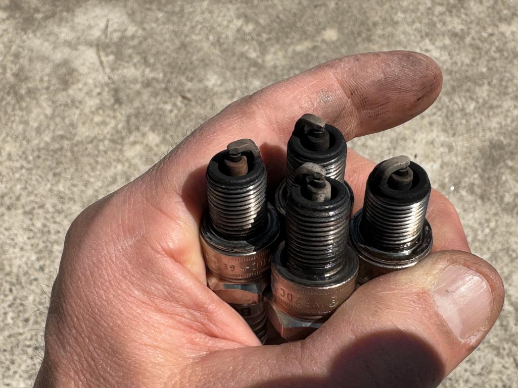

- Plugs look okay (see attached)

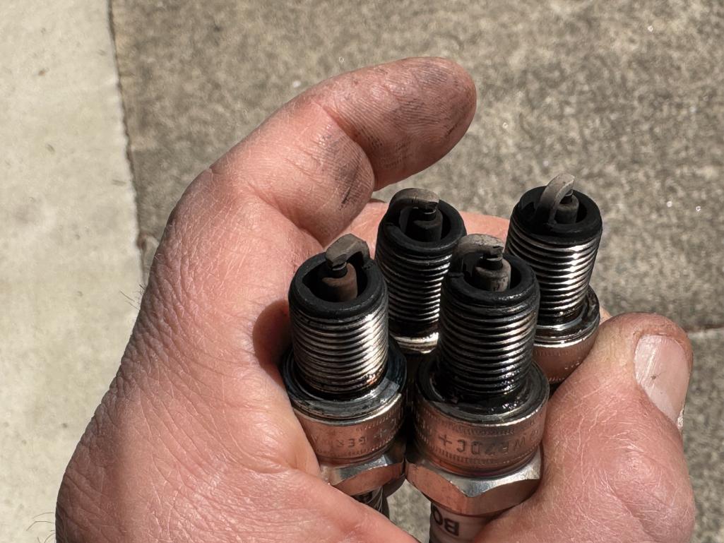

Spark plug pics. Have not tried to start the car since last weekend, so these are after the last time it "ran".

Superhawk996   In photo of the plug - why does the compression w...   Mar 17 2025, 07:09 PM

Superhawk996   Would be useful to see condition of all 4 spark pl...   Mar 18 2025, 07:51 AM

Blue Lightning   In photo of the plug - why does the compression ...   Mar 18 2025, 04:16 PM
