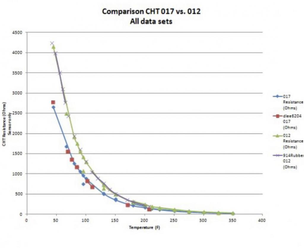

- CHT reads 2k at cold, ~250ohms at warm/hot (at splice connector)

CHT 3k at ambient of around 60F is fine . 76’ 2.0L used the 012 CHT sensor

Blue Lightning   Pulled the CHT from the engine. Measured: 2500 o...   Mar 22 2025, 02:04 PM
