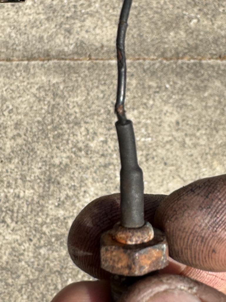

Pulled the CHT from the engine. Measured:
2500 ohms at 70F
230 ohms at 212F
These match the data here for the 012 sensor ('76 2.0): http://www.914world.com/bbs2/index.php?sho...351065&st=0
Did notice that the wire coming off the CHT has some insulation scraped away. Going to add heat shrink before reinstalling. This is one of the grommets that is missing from the engine tins.
