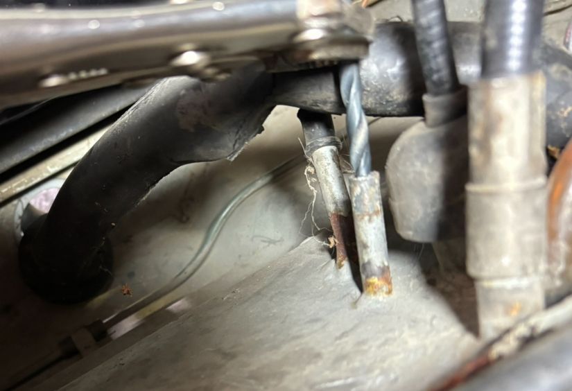

OK, once more with feeling….
This is the 74 that had the misrouted accelerator cable. That has been removed so now I have what I believe is the original accelerator cable, the arrow is pointing at it, which is good in stock in the tunnel.
Even with vice grips on it, I can’t pull it out and it doesn’t really wanna move forward either.
I’m going to have to remove this before I install replacement cable so any ideas or suggestions?

Philips head wobble technique didn’t work (or at least not yet).
Tried a drill bit (with nice grips so gently) and it’s catching on something. Should I get power to the drill bit to see if I can remove the edge it is catching on?
Seem a bit desperate, which wouldn’t be a wrong conclusion at this point. Ha.

QUOTE(Tdskip @ Mar 23 2025, 01:32 PM) *
Bad plan
The tube doesn’t go straight for any significant distance and you’ll drill into the side of it (or through it) if not careful.
Review the picture of what you’re dealing with

Tdskip   Any chance the replacement cables have larger fitt...   Mar 25 2025, 06:28 PM
Superhawk996   Any chance the replacement cables have larger fit...   Mar 26 2025, 07:31 AM

Tdskip   Thanks for all of the replies and attempts to help...   Mar 26 2025, 12:44 PM
Tdskip   Should I try very minimally shaving/grinding a bit...   Mar 26 2025, 12:51 PM

Tdskip   OK - got it! In the end it was the tube being...   Mar 26 2025, 01:08 PM

914werke   Reminded me... Heres one. OG cable came out of the...   Mar 28 2025, 05:43 PM
Superhawk996   Turned out a PO's errant sheet metal screw h...   Mar 28 2025, 06:04 PM
914werke   Turned out a PO's errant sheet metal screw h...   Mar 28 2025, 07:38 PM
Superhawk996   I like the creativity of the brazed drill bit solu...   Mar 28 2025, 10:43 PM
