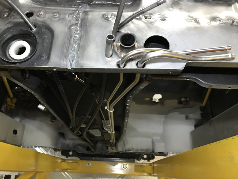

Be aware there is a lot of variance in how and when the cable tube begins to bend
Here is my car when I rebuilt the tubes from scratch - the accel cable tube goes in straight for a while
You might get by with a variable speed drill and turning it very slowly but I’d only do that as an absolute last resort Attached Image
I might try a rat tail file first before the drill
A file is a lot better at dealing with hardened material if there is some sort of weld / braze slag inside the tube
