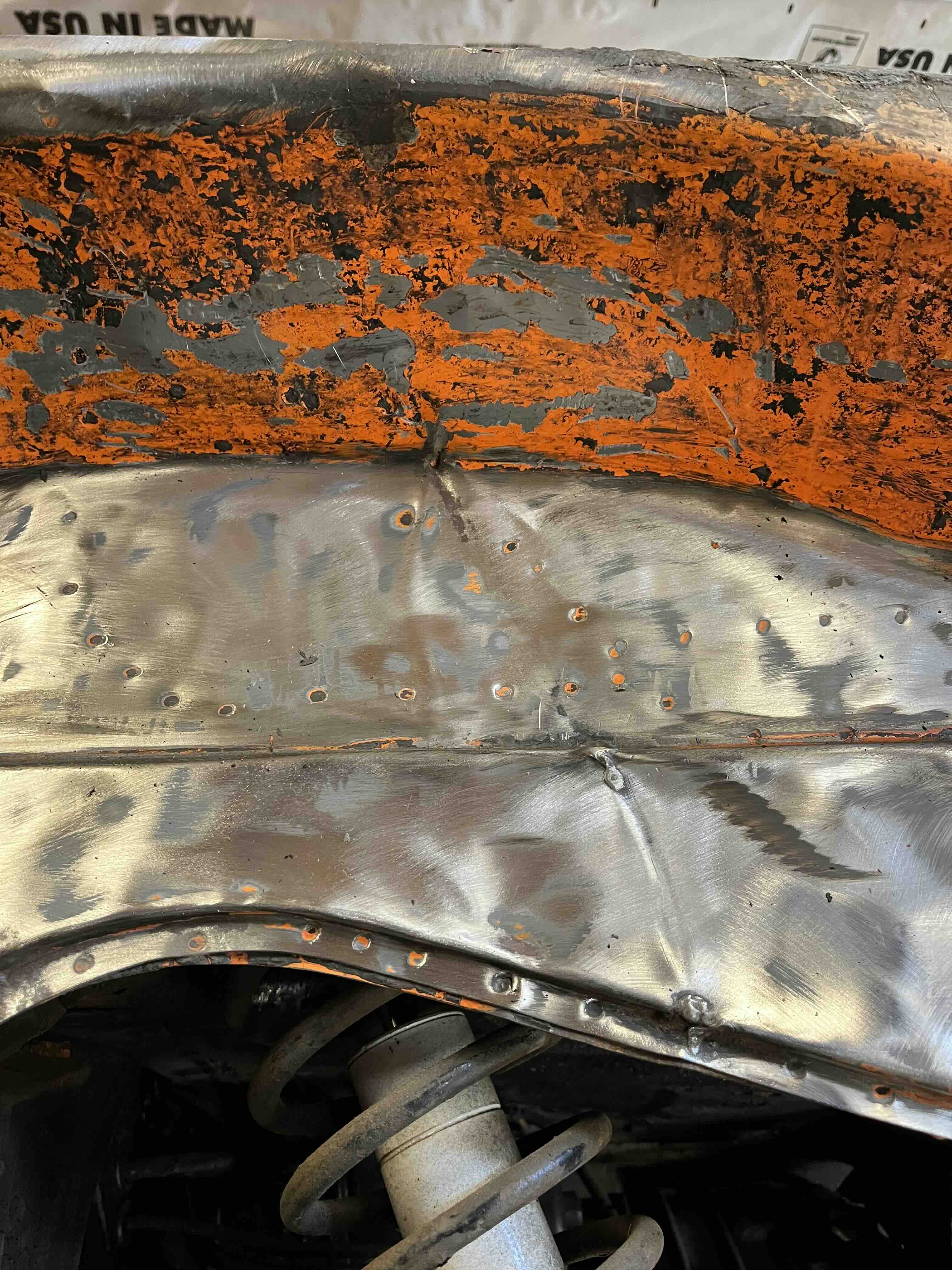

I'd appreciate advice on how to go about repairing some old collision damage from a rear LH impact that deformed the crumple zone. In the photo you may be able to make out a vertical crease that was previously straightened out just behind the rear strut and going from the bottom pinch seam up the top of the inner wheel well (maybe beyond that....still cleaning out the undercoating).

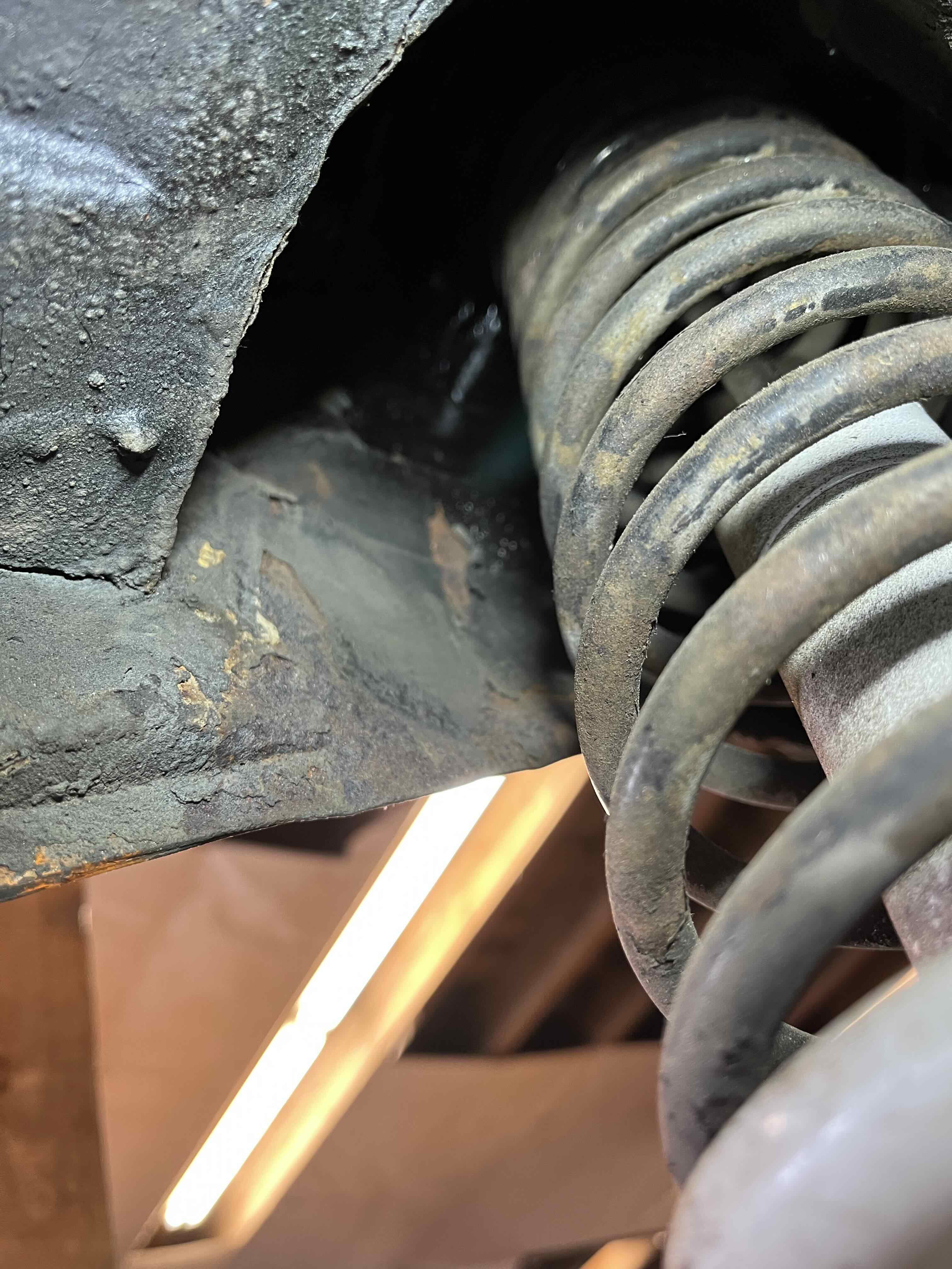

@mate914 Best photo I could get of the inside of the shock tower is below. Car still has suspension and engine mounted (been hoping to get away without pulling engine since the car ran and drove when I bought it).
You can see where the collision crease was partially pulled out on the outside of the inner wheel well in one photo and in the second you can see that the inner part of the shock tower was also creased (and apparently not repaired).
