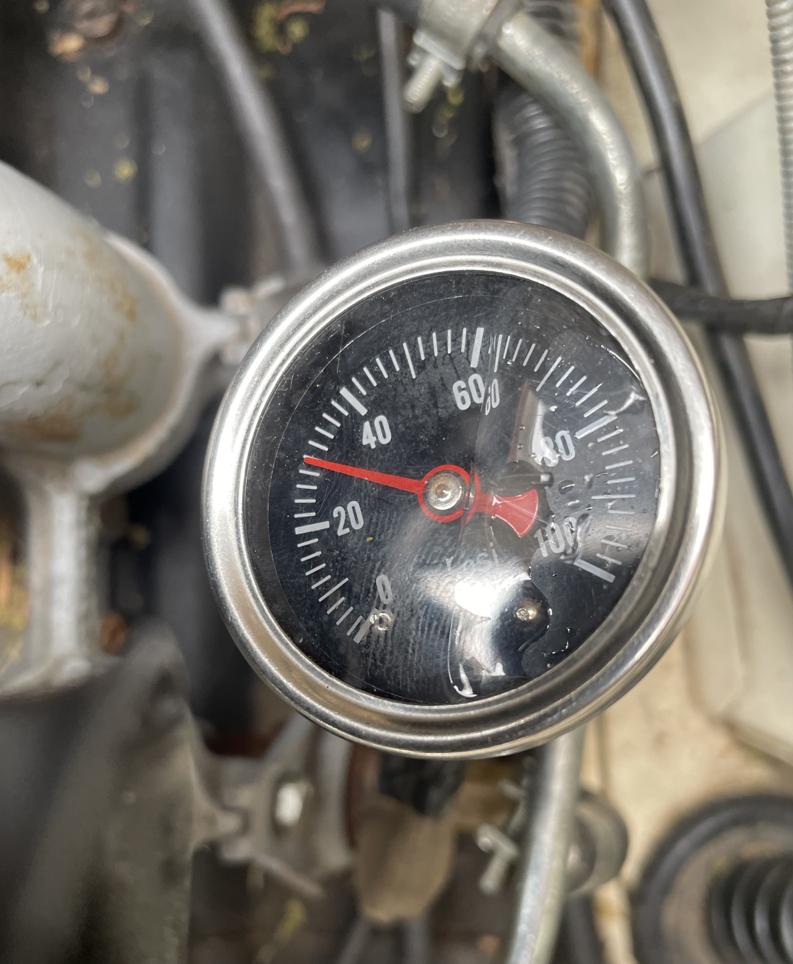

I installed my replacement engine side hard lines today.. not really a surprise to see the pressure gauge doing what it should considering the clogged pipes.. but it’s certainly a relief nonetheless!
After that, I reinstalled my CSV & trigger points (which I took out for no reason apparently- didn’t know what to check for). The engine tried to catch a couple times but the battery sounded week.. will try again and report.
Pic is from the driver’s side just before the regulator.
