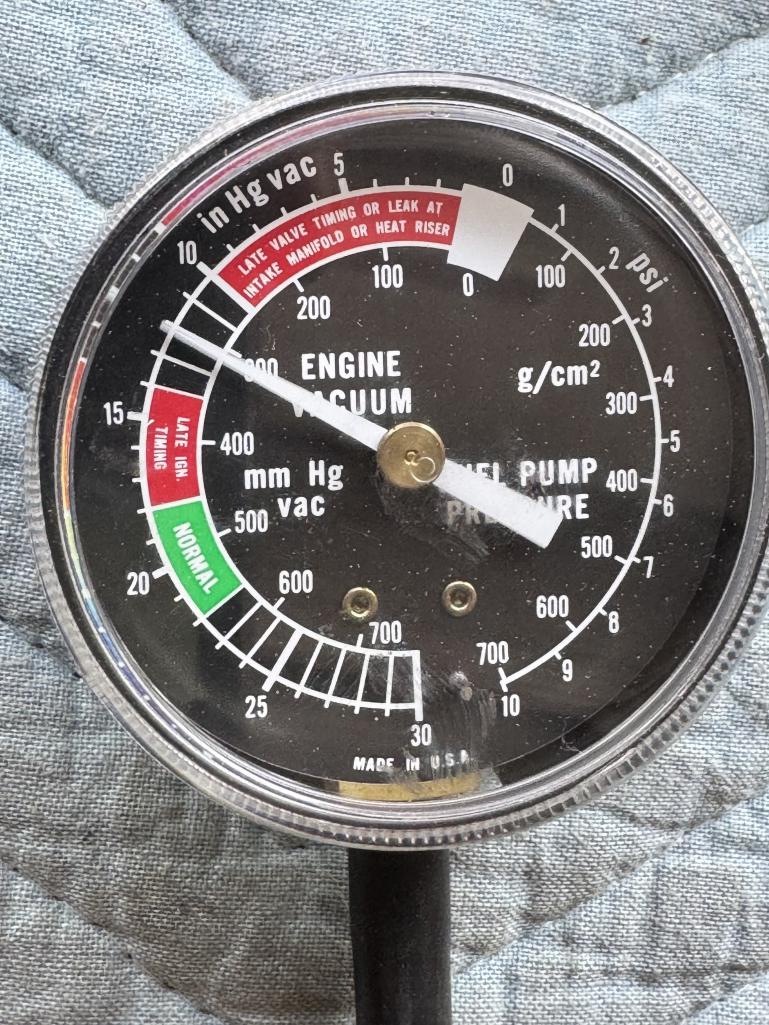

Didn't try a different coil, as I was getting visible spark on all 4 plugs.
I checked the vacuum at idle...and it is pretty bad: https://youtu.be/XOzUYy50ztY
Guess I'm going leak detecting again...maybe I need to check the valve adjustment I did again?
Toward the end of that video, I have the vacuum pump pulling on the MPS, and the idle speed increases significantly (until I hit around 15 inHg, where it dies).

emerygt350   Here is a nice clear guide on what a vacuum gauge ...   Mar 25 2025, 07:02 AM
Ron914   Here is a nice clear guide on what a vacuum gauge...   Mar 25 2025, 10:16 AM

Ron914   @Blue Lightning Here are a pictures of again what...   Mar 27 2025, 08:40 AM
