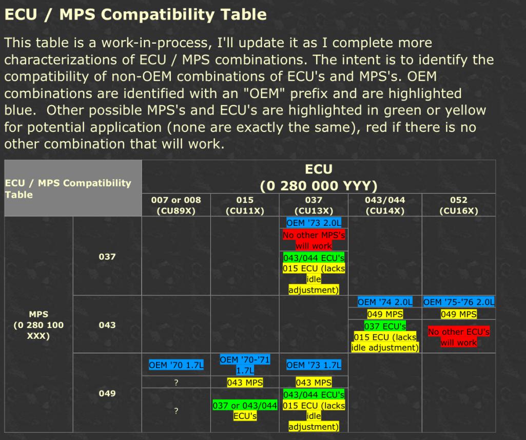

You mention that the MPS is new / rebuilt from AA?:
1) is the part number correct and matching the ECU and the rest of the system? Ie - not all MPS are the same.
2) have you vacuum checked the new one? For some reason I’m assuming yes but not sure.
3) what vacuum level are you pulling on the plenum? I’m wondering if that whistle is a huge vacuum leak somewhere that is killing the plenum vacuum

Yes backfires. That's why I was reaching to shut it off...don't want to wreck anything.
The MPS is the "Euro" version. I had a 043 and when I went by AA George Hussey recommended going with the 037 "Euro" part instead (and he had those, but no 043s). And yes, have vacuum tested the new part several times (IMG:style_emoticons/default/smile.gif)
The screaming seems to be air leaking around the throttle plate or going through the idle air passage. When I put the filter on, I think you are just hearing the sound attenuation from that. In carbureted cars I own, I would set the gap between the throttle plate and the throttle body to control the amount of air/vacuum at idle, but that doesn't seem to be a thing for the 914 throttle bodies (just the idle air screw). I'm beginning to wonder if something is in the idle air passage in the throttle body...

QUOTE(Blue Lightning @ Mar 23 2025, 05:49 PM) *
So AA is back up to the old tricks? (IMG:style_emoticons/default/chair.gif)
Parts should not be mix and match. An 037 is not an 043 which is why it has a different part number.
The 037 is for the 73’. However, the 73 1.7L and the 2.0L use the same ECU and have some “tricks” played with the CHT and the calibration of the MPS to differentiate the calibrations to compensate for the 1.7L to 2.0L displacement change while using the same ECU. Both the MPS and the EcU for 73’ are different than the 76’ setup.
I assume you’re aware of the Brad Anders parts lists and the recommendation not to mix and match.
The MPS you have can be retuned but that isn’t part of what you bargained for. There is some bench calibration that can be done but per the guys (like Emery) that have retuned their MPS, you will really want to tune it on-road with a wide band air fuel meter.
Don’t get me wrong, I don’t think all of your difficulties are related to the MPS.

Ron914   @Blue Lightning Here are a pictures of again what...   Mar 27 2025, 08:40 AM
Blue Lightning   [b] Thanks, but I think that second one is the ...   Mar 29 2025, 12:01 PM
