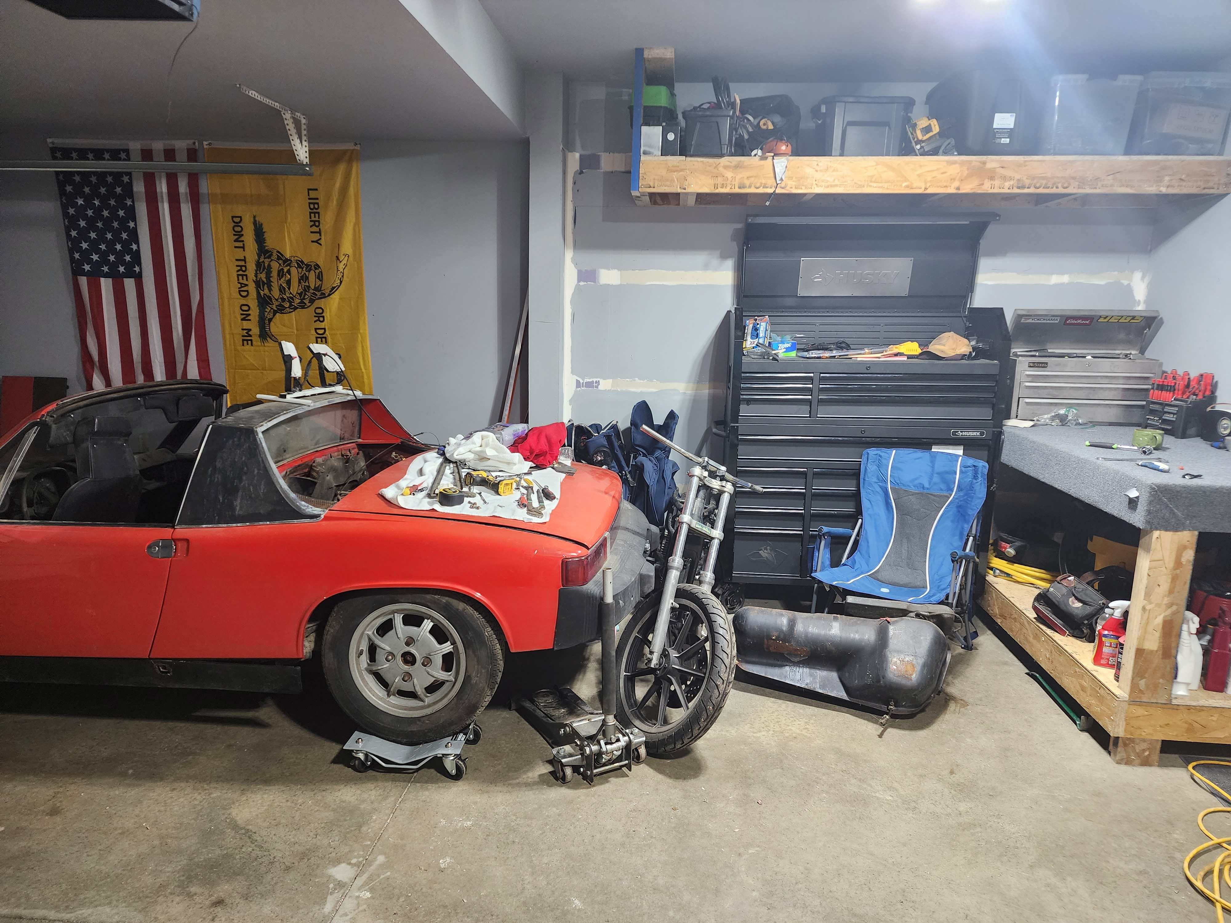

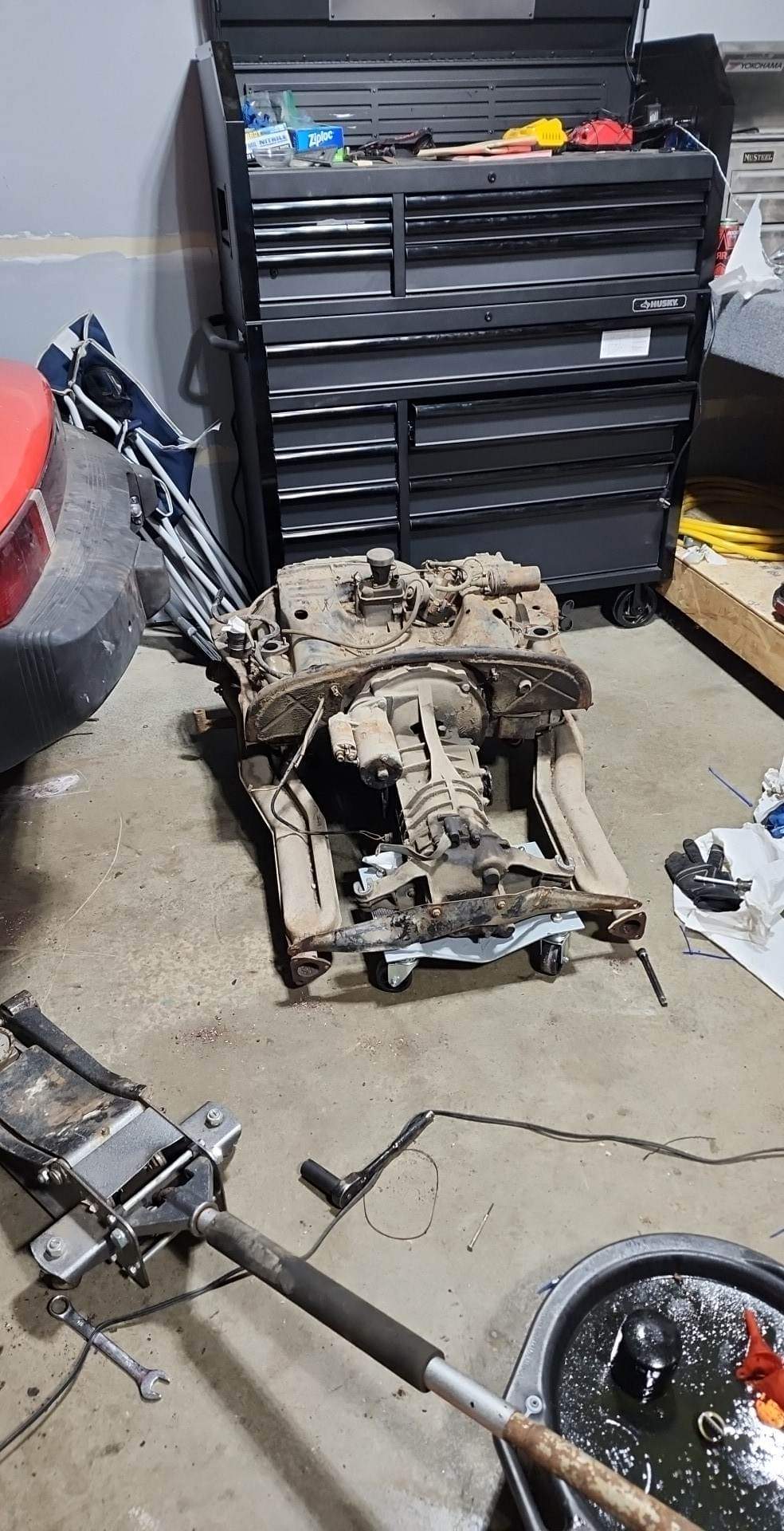

Got it into my garage, and being the overzealous dummy that I was I got to work tearing it down to get it ready for the road. The hellhole was in great shape, the cylinders, pistons and heads appeared to be in great shape. Im glad i did not try to start it as there was some nests inside the tins that would have blocked the cooling flanges from opening. What confused me then and continues to confuse me now is the rust. The body had no rust, very very clean. Far from perfect but clean. Not surprising considering it had been stored inside. But the exhaust and heat exchangers had completely rusted through, The engine tins had a lot of surface rust and in some spots had begun rusting through. The jugs of the cylinders had a lot of surface rust, several of the bolts for the tins were rusted to the point they snapped with very minimal force applied, even with PB. Back to the dummy part. In my haste and inexperience, I got straight to work. Gutted the interior, dropped the motor, pulled the gas tank so I could replace all the gas lines. Dissassembled the motor. I didn't document anything well enough. I thought I'd be putting this car on the road in the matter of a few months and could operate from memory reassembling.
