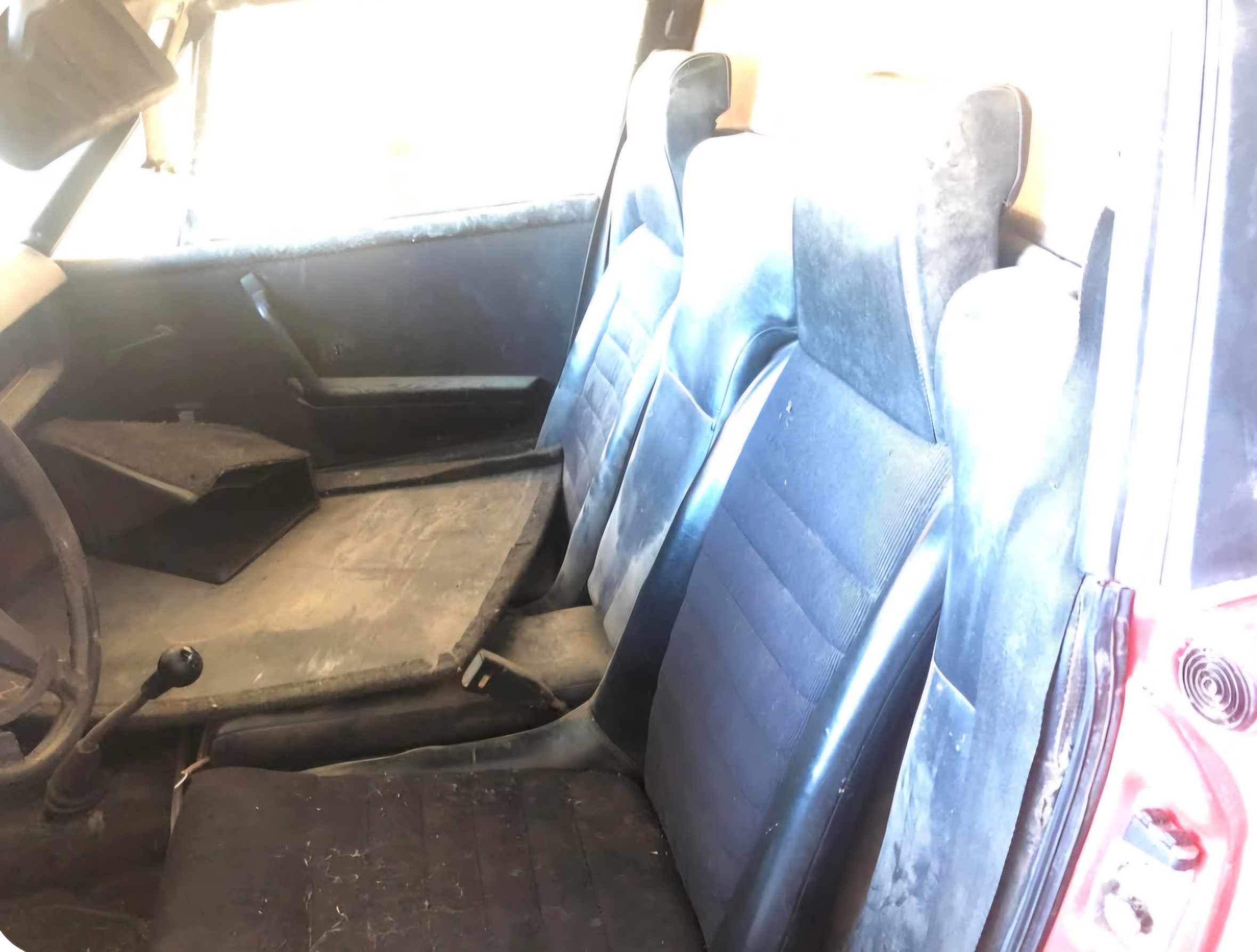

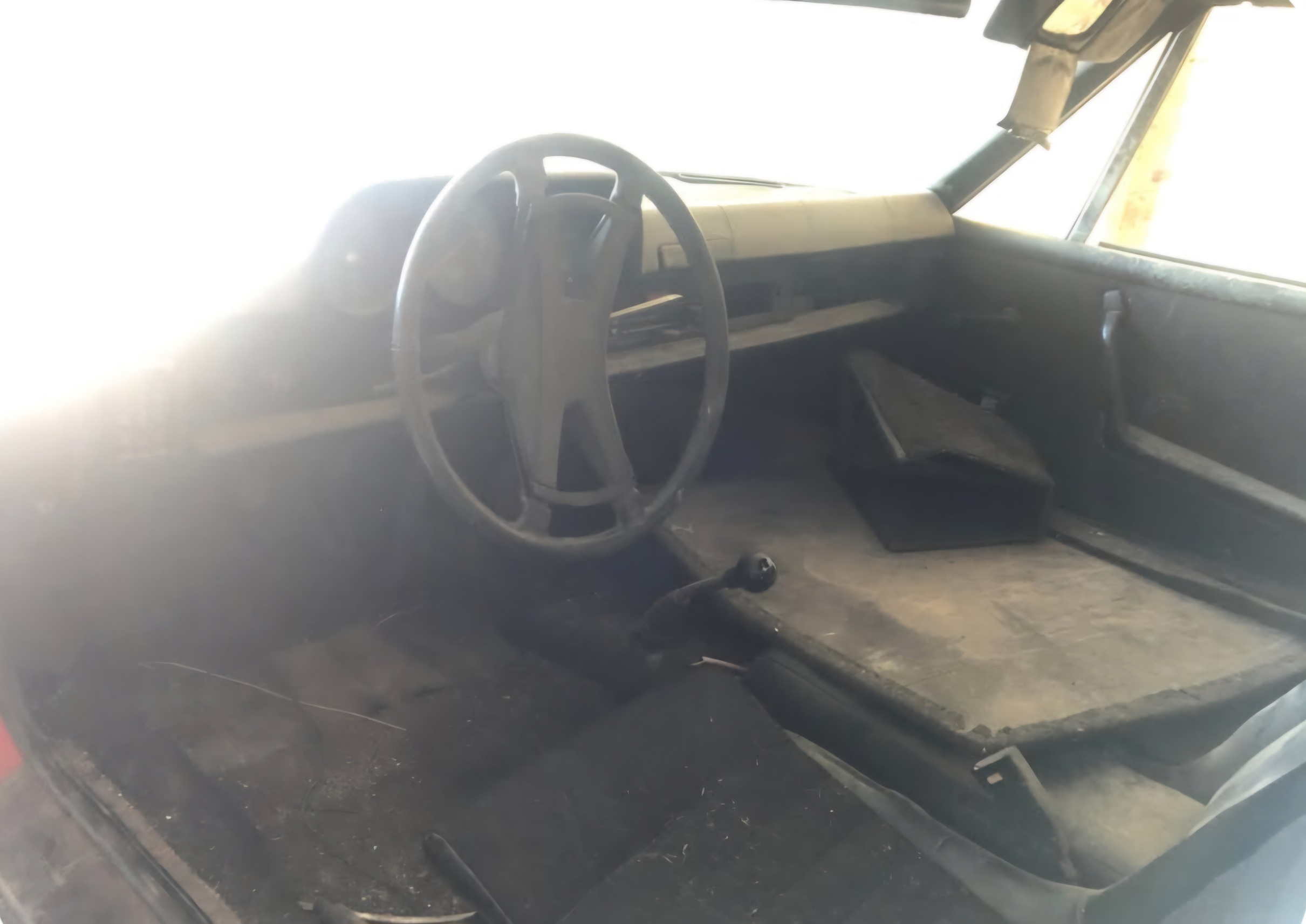

I've always wanted to own a 914. My dad had a few before I came along and talked about it often. In high school we looked for one to build together but it never happened. In July of 2022, I was visiting my goddaughter at her grandfather's house when the grandfather and I got to talking about cars. He was talking about Karmann Ghias and I said something along the lines of "I'd much rather have a Porsche 914" to which he responded "I've got one. Its been sitting for 20 years" I jokingly told him to let me know if he wanted to sell it. When he came back and said for $1000.00 I could have it I agreed sight unseen.
August of 2022, still never having seen the car, I made the 4 hour drive back with my trailer to pick up my new to me 914. I had no idea what to expect and honestly expected the worst. It had been sitting for 20 years after all. This is the backstory I was given, as best I can remember:
In the early 2000s, he took his rusted out 1973 (i think) 914 to a shop in Des Moines, IA to be restored. They ultimately decided to pick up a shell in I believe Arkansas and frankenstein a car together. Thus why my 1975 has a 1.7L in it. Car got a fresh coat of paint and a rebuild and he drove it home. He was then unable to title the vehicle due to the body swap, stashed it in the back of his shed and never touched it again. Unfortunately, after all this time, he was unable to find any of his paperwork or keys to the vehicle.
Here's how the vehicle looked after getting it out of the shed.

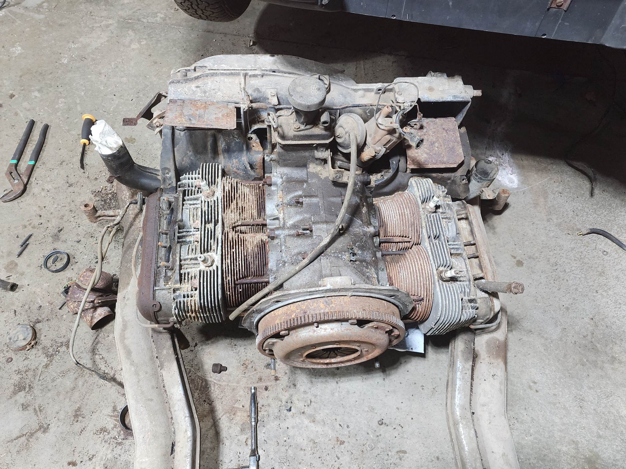

Spoke   -motor rebuild Having owned a 1.7L, 1.8L, 2.0...   Mar 24 2025, 02:16 PM
Vicious   -motor rebuild Having owned a 1.7L, 1.8L, 2....   Mar 24 2025, 03:42 PM

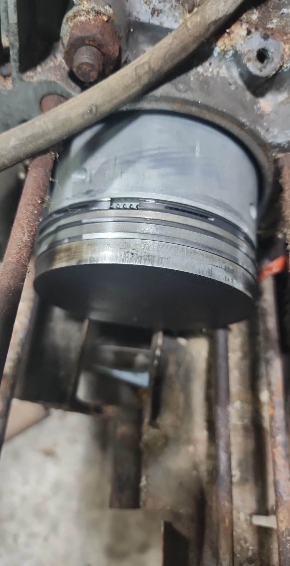

Vicious   Good news! As previously stated, the guy i bou...   Mar 25 2025, 03:36 PM
914sgofast2   Those heads are very crusty. Looks like they have...   Mar 25 2025, 03:52 PM
Vicious   Those heads are very crusty. Looks like they hav...   Mar 25 2025, 04:00 PM
emerygt350   Unless you are serious about keeping this cheap, t...   Mar 25 2025, 04:09 PM

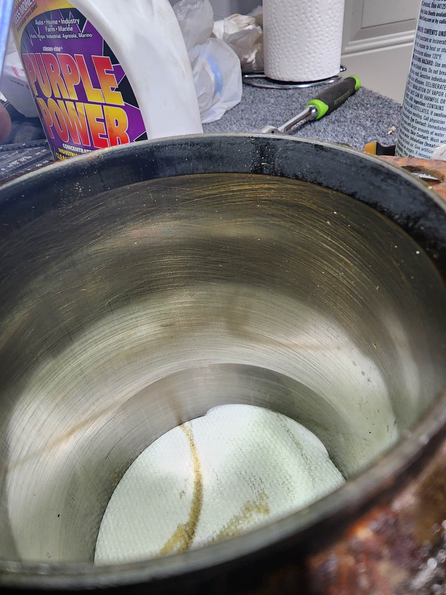

rhcb914   Those jugs and pistons look like the old 96MM NPR ...   Mar 25 2025, 07:54 PM
Vicious   Those jugs and pistons look like the old 96MM NPR...   Mar 25 2025, 09:56 PM
Artfrombama   I don't see major corrosion. I see parts that ...   Mar 26 2025, 11:13 AM
914sgofast2   Based on you photos, it looks like those heads won...   Mar 26 2025, 12:48 PM
Vicious   Based on you photos, it looks like those heads wo...   Mar 26 2025, 02:34 PM
rhcb914   I can tell by the thin wall of the cylinder sealin...   Mar 26 2025, 08:10 PM

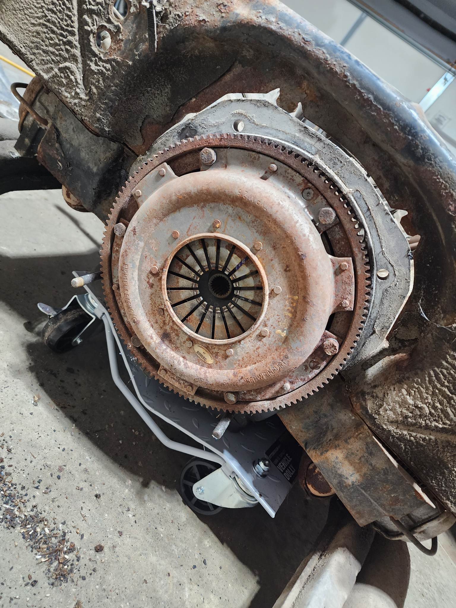

Vicious   Still waiting on my type 4 yoke to arrive so I can...   Mar 29 2025, 03:01 PM
Vicious   I haven't even started getting going on assemb...   Apr 3 2025, 06:02 PM
