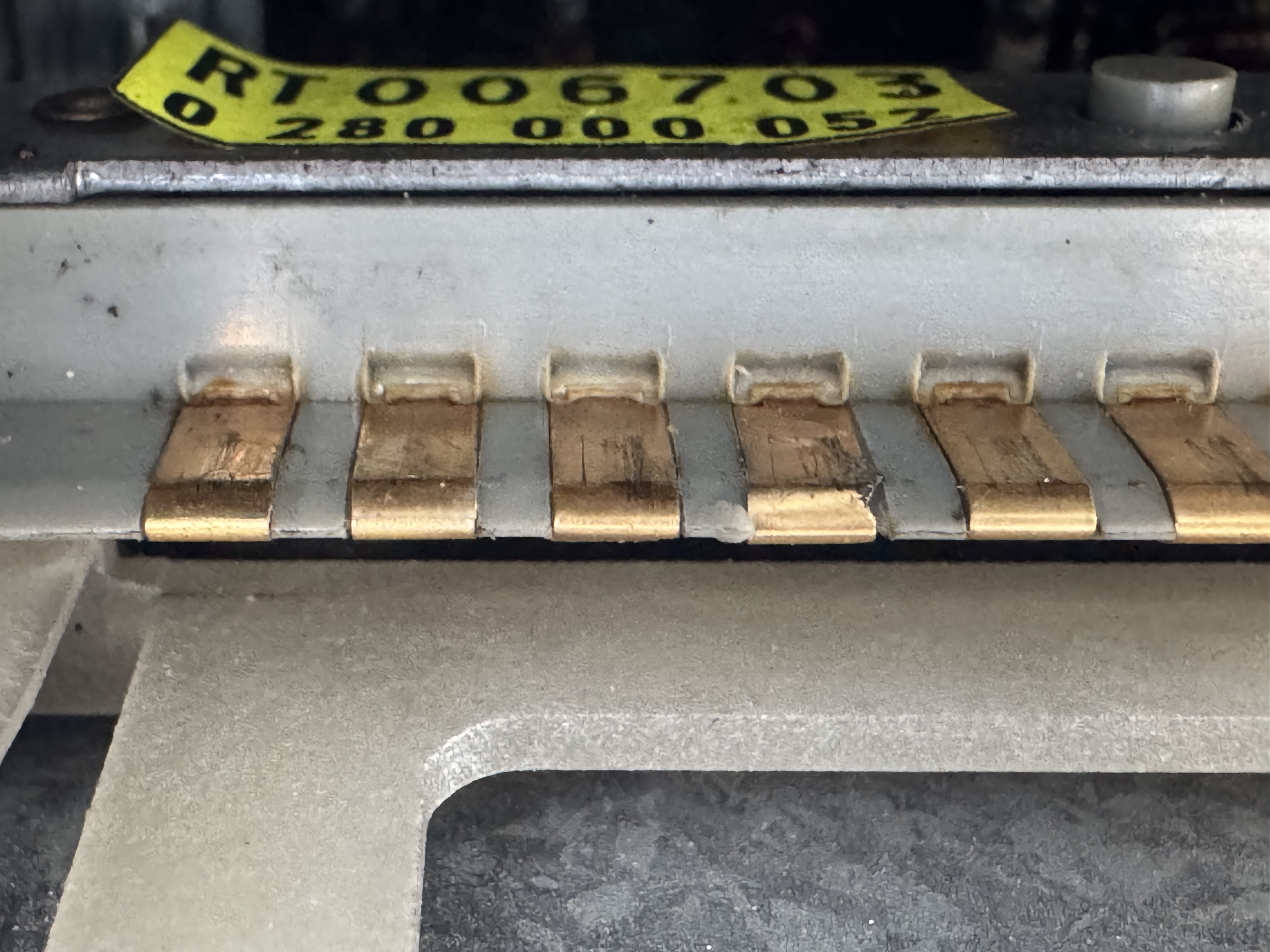

Blue Lightning
post Mar 24 2025, 04:36 PM
Posts: 78
Joined: 7-December 23
From: Atlanta, GA, USA
Member No.: 27,780
QUOTE(Blue Lightning @ Mar 24 2025, 09:29 AM) *
The parts in the engine current are:
Engine: GC (correct for '76 2.0)
ECU:0 280 000 052
Fuel Injectors: 0 280 150 038 (correct for '76 2.0)
CHT: resistance/temp curves are consistent with a 012 (correct for '76 2.0)
Thermotime: ??? (not cold enough out for me probably ever to need)
Deceleration Valve: ???
MPS: 037 (now incorrect)
Distributor: 011 / 205A (for '76 2.0 GA-series engine; correct for GC would be the 021 / 205B)
I've spent time looking at the differences between the 205A and 205B distributors, but have not found anything (this is the best reference I have found for the 205A: https://web.archive.org/web/20031213100259/...h/distrib.html)
I've read some stuff on retuning your MPS, but at some point you should just put in a megasquirt or something that and take advantage of a WB02 sensor and maybe have some closed-loop idle control (IMG:style_emoticons/default/smile.gif)
Confirmed ECU is correct for the car
Superhawk996
post Mar 24 2025, 06:41 PM
Posts: 8,058
Joined: 25-August 18
From: Woods of N. Idaho
Member No.: 22,428
QUOTE(Blue Lightning @ Mar 24 2025, 06:36 PM) *
(IMG:style_emoticons/default/smilie_pokal.gif) worth knowing that information.

Ron914   @Blue Lightning Here are a pictures of again what...   Mar 27 2025, 08:40 AM
Blue Lightning   [b] Thanks, but I think that second one is the ...   Mar 29 2025, 12:01 PM
Blue Lightning   So took the advice of checking the valve adjustmen...   Mar 29 2025, 12:10 PM
Ron914   So took the advice of checking the valve adjustme...   Mar 29 2025, 04:16 PM
