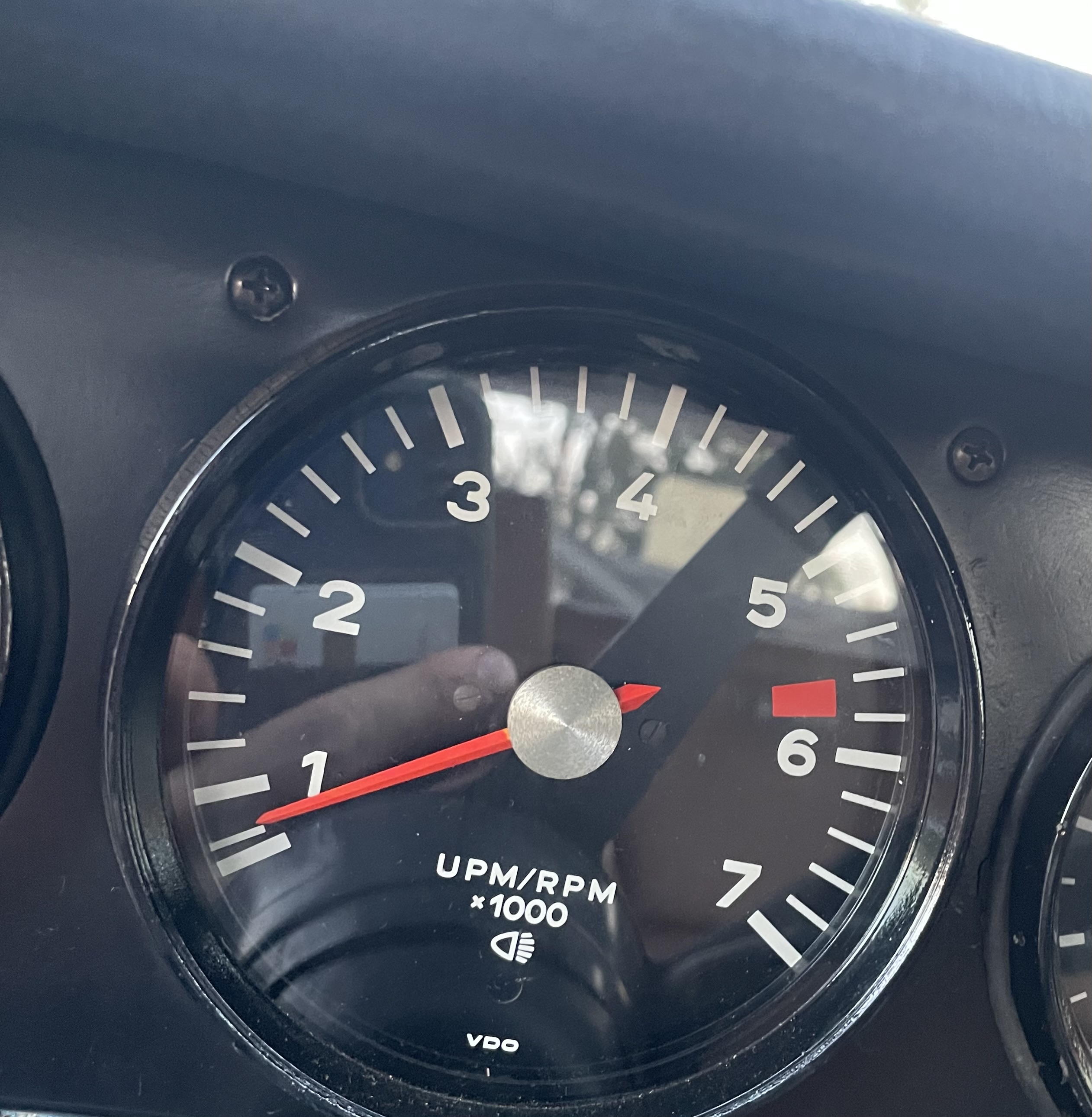

My Tach while it’s idling:

Literati914   Now that my fuel pressure issue 'seems' li...   Mar 24 2025, 03:44 PM
emerygt350   Just upload it to YouTube and share the link. Sup...   Mar 24 2025, 04:03 PM
emerygt350   Low idle could be a rich mix, but first make sure ...   Mar 24 2025, 04:04 PM
Literati914   Here’s a video of .. let’s call it first start...   Mar 24 2025, 06:59 PM
Literati914   Revving it to 28-2900rpm approx: https://youtube...   Mar 24 2025, 07:01 PM
Literati914   My Tach while it’s idling:   Mar 24 2025, 07:08 PM
Superhawk996   :trophy:   Mar 24 2025, 07:14 PM
Literati914   Hey thanks to you guys!! @Superhawk996 a...   Mar 24 2025, 09:40 PM
Spoke   Engine sounds good. Congratulations on solving the...   Mar 24 2025, 11:29 PM
emerygt350   Yes, it sounds just like it should. For afr you n...   Mar 25 2025, 05:19 AM
