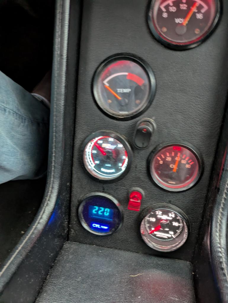

Here is a video of mine at cold start this morning. You can see how the vacuum starts and where it is after a minute and a half. The video starts maybe 5 seconds after I started the car. Didn't think of it till I started otherwise I would have recorded that for you too.
https://www.youtube.com/shorts/-owQvPa68sc
Don't mind the wonky AFR, it takes forever for that thing to kick on.
Here is where all the needles are after my 1 mile commute to work.

Blue Lightning   Went for a drive, maybe 30 minutes around the neig...   Mar 30 2025, 01:32 PM
emerygt350   That oil seemed to heat up pretty quick. Makes me...   Mar 30 2025, 03:32 PM
Blue Lightning   That oil seemed to heat up pretty quick. Makes m...   Mar 30 2025, 04:38 PM
emerygt350   Return spring is good right? Throttle moves easil...   Mar 30 2025, 05:03 PM
