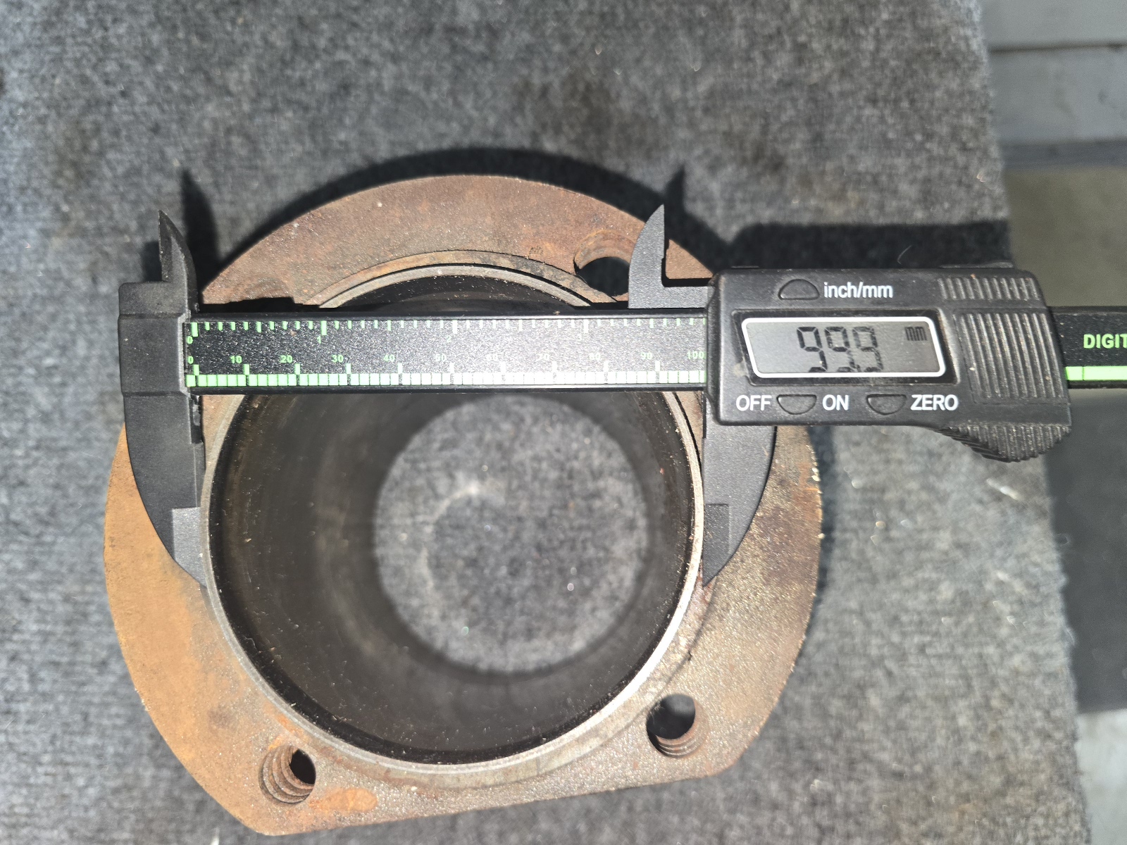

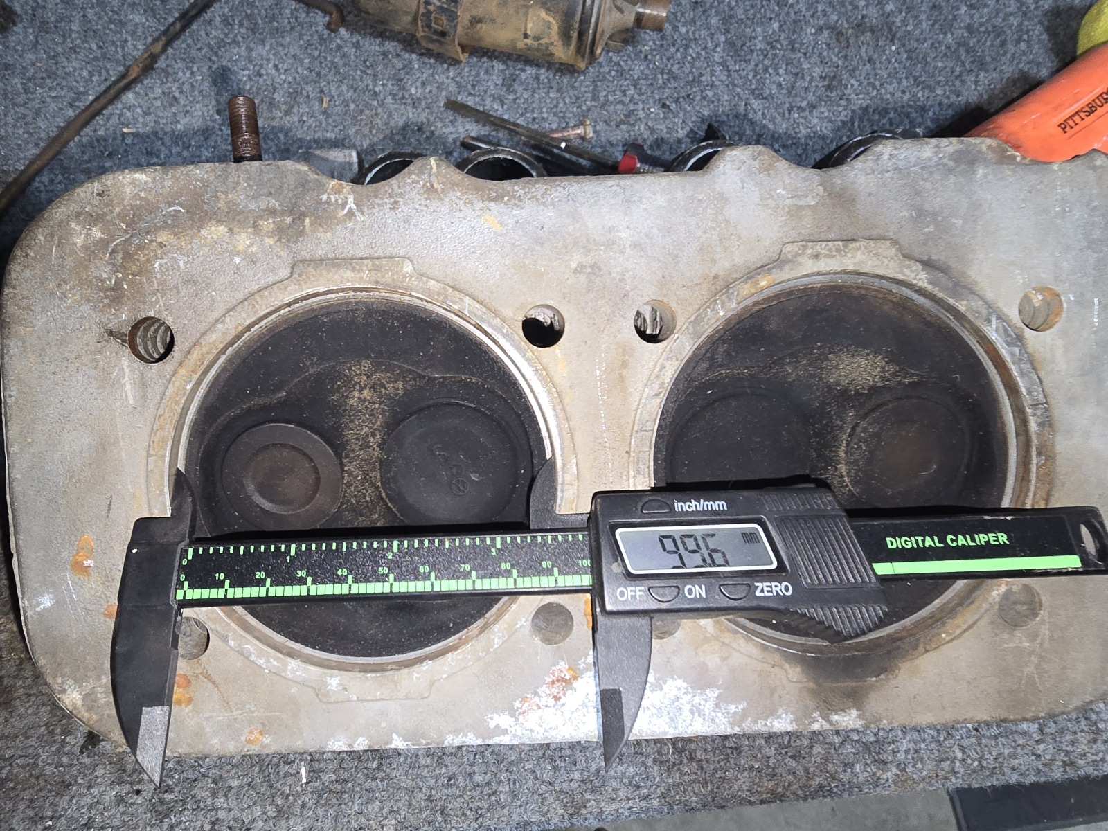

Those jugs and pistons look like the old 96MM NPR slip in big bore kit. You should measure the diameter of the heads, I bet they weren't flycut. That would also explain why the oily combustion.
You could rebuild the heads if you are on a tight budget have them opened to take the machine in 96MM kit. I am running 1.7 heads w/96 and really like that combo but there are tons of options. The 1.7 / 1.8 tins are the same. Only need to change the angle if you go the 2.0L head route.

QUOTE(rhcb914 @ Mar 25 2025, 08:54 PM) *
Got me curious, had to hop out of bed and run to the garage to check. I'm not really sure what the number should be but ive attached some photos. Based off everything im seeing it wouldn't surprise me if thats what they were.
I really appreciate you saying something though. I had no idea that existed and would've been very disappointed to figure it out mid assembly.
