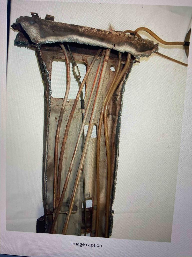

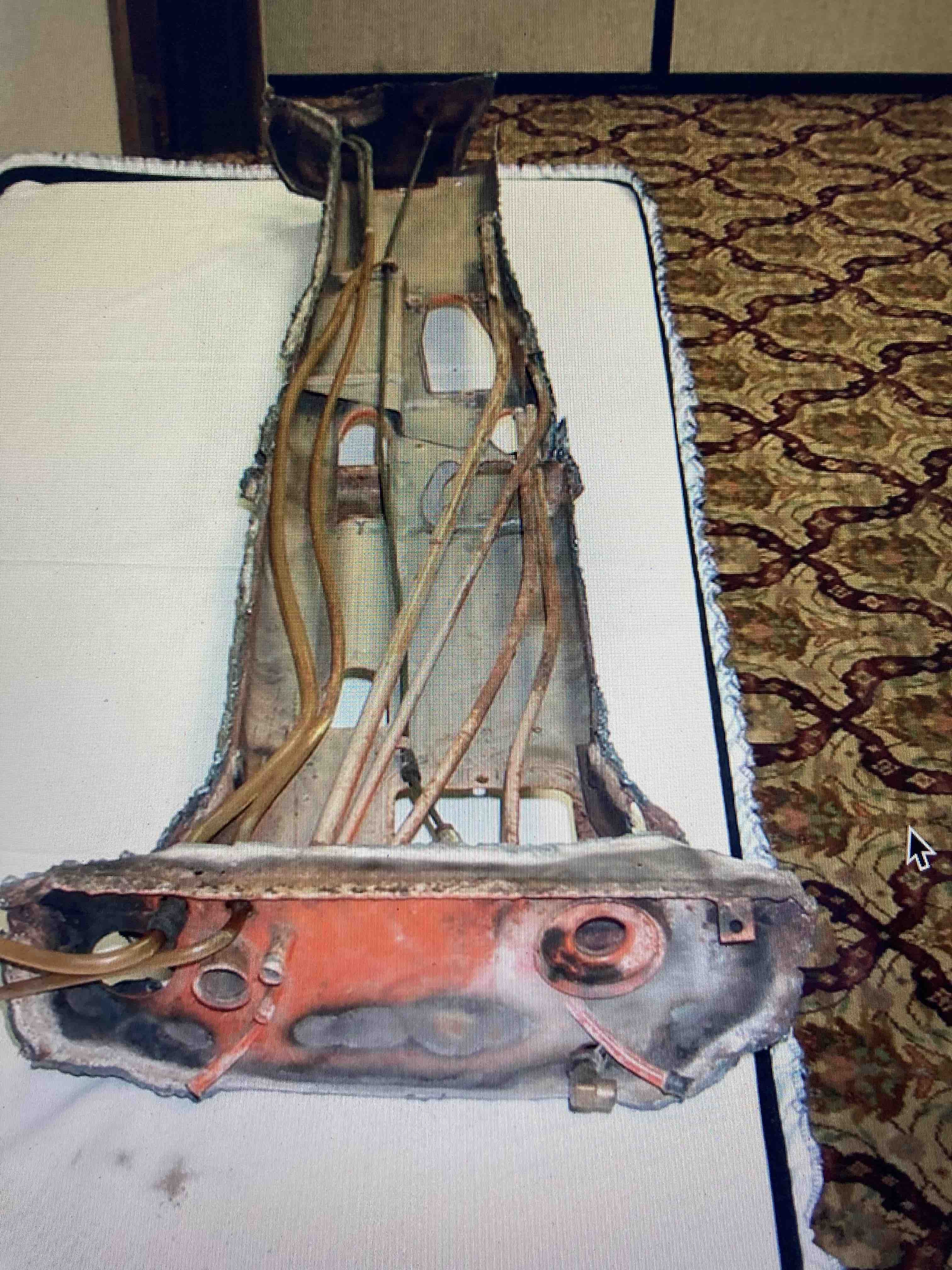

Good morning Tom , @Tdskip
I found these photos on the internet somewhere of the tunnel exposed to help me see what goes on in there . I don't know what year of 914 they came from but the helped and I saved them for future use if ever needed.

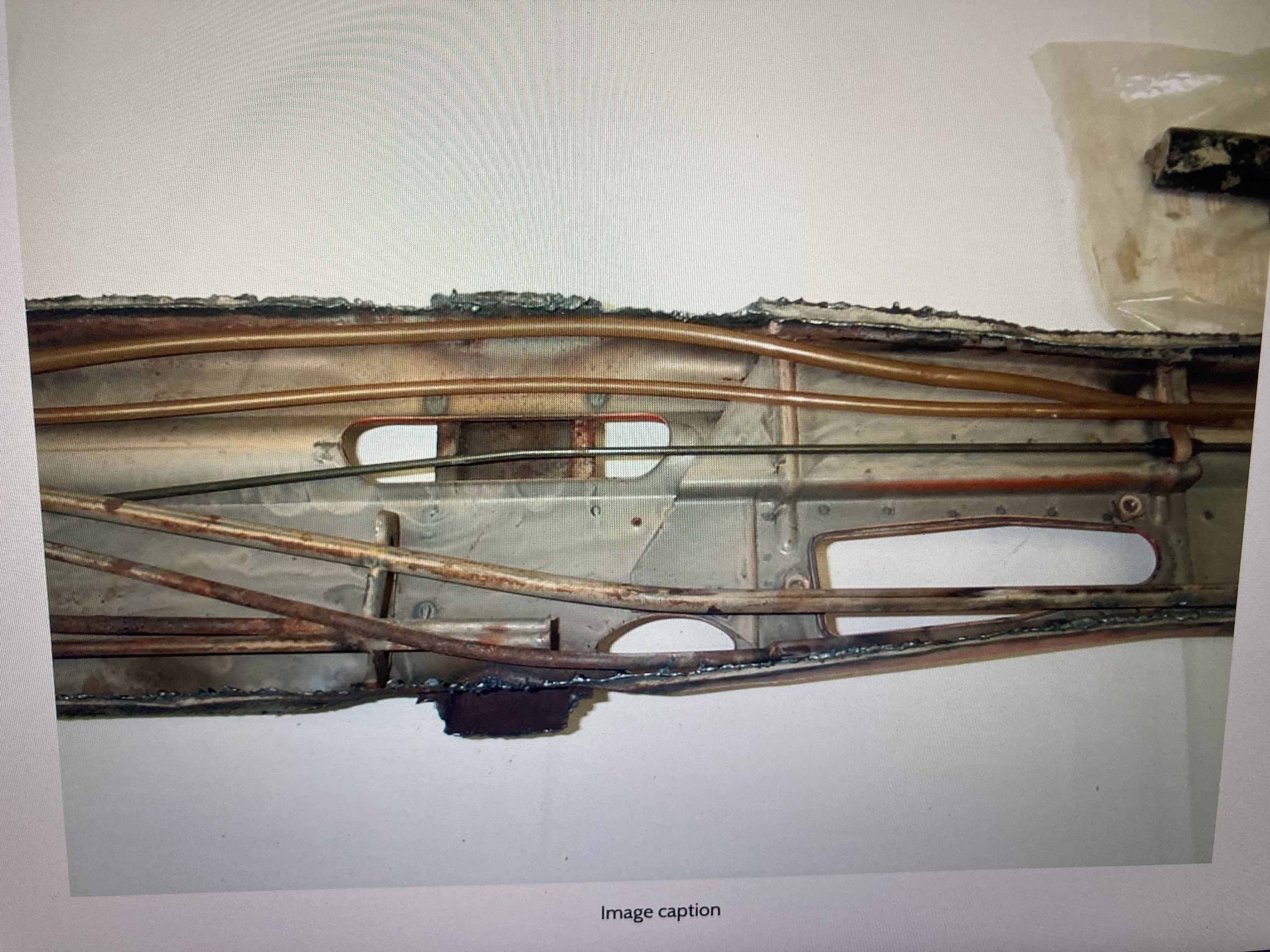

Ron914   Good morning Tom , @Tdskip I found these photos ...   Mar 26 2025, 07:05 AM
Ron914   and two more   Mar 26 2025, 07:07 AM
