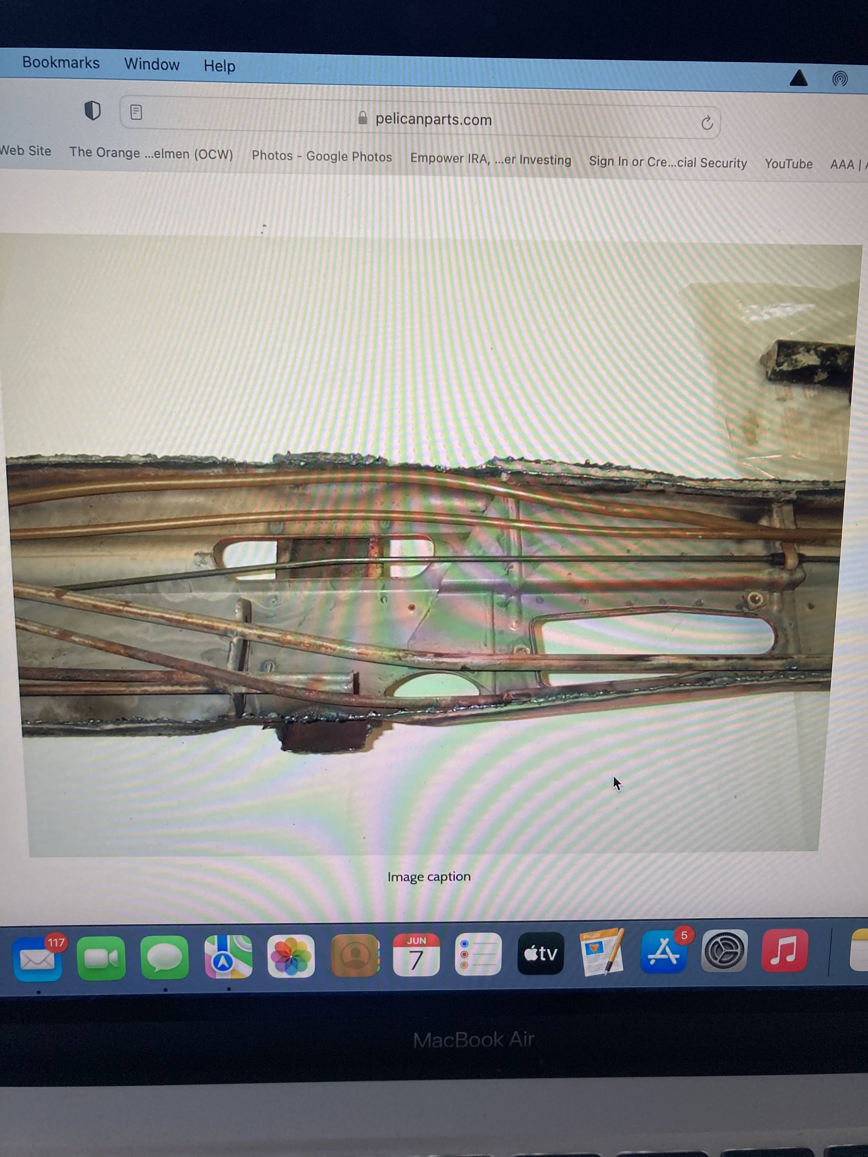

Dave_Darling   Photos of what is inside the tunnel can be found h...   Feb 10 2025, 07:44 PM
rjames   Photos of what is inside the tunnel can be found ...   Feb 10 2025, 09:23 PM

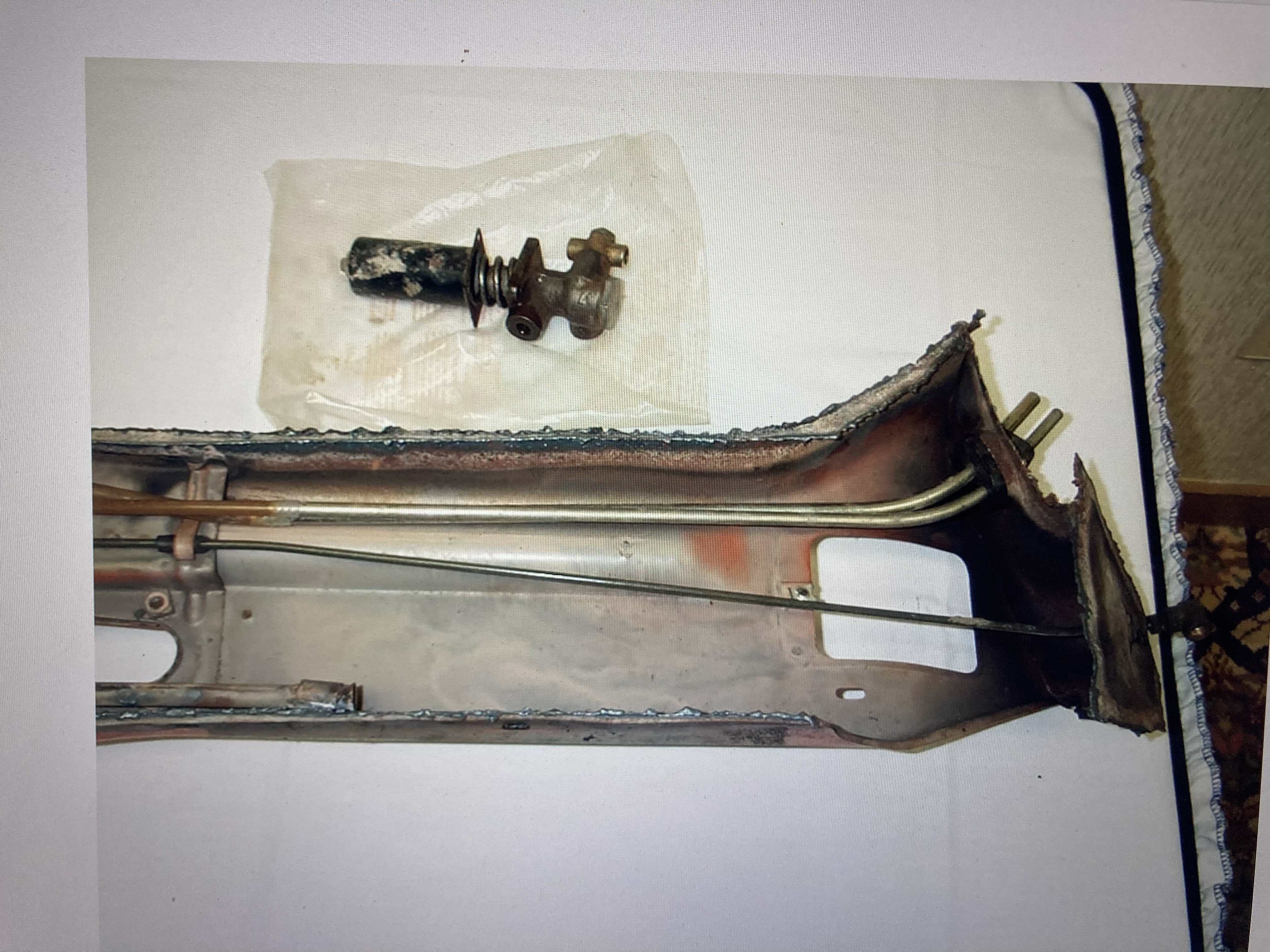

Ron914   Good morning Tom , @Tdskip I found these photos ...   Mar 26 2025, 07:05 AM
Ron914   and two more   Mar 26 2025, 07:07 AM

Ron914   You probably don't remember me Tom but I purch...   Mar 26 2025, 12:56 PM
Tdskip   You probably don't remember me Tom but I purc...   Mar 26 2025, 01:25 PM
Ron914   You probably don't remember me Tom but I pur...   Mar 26 2025, 01:31 PM
