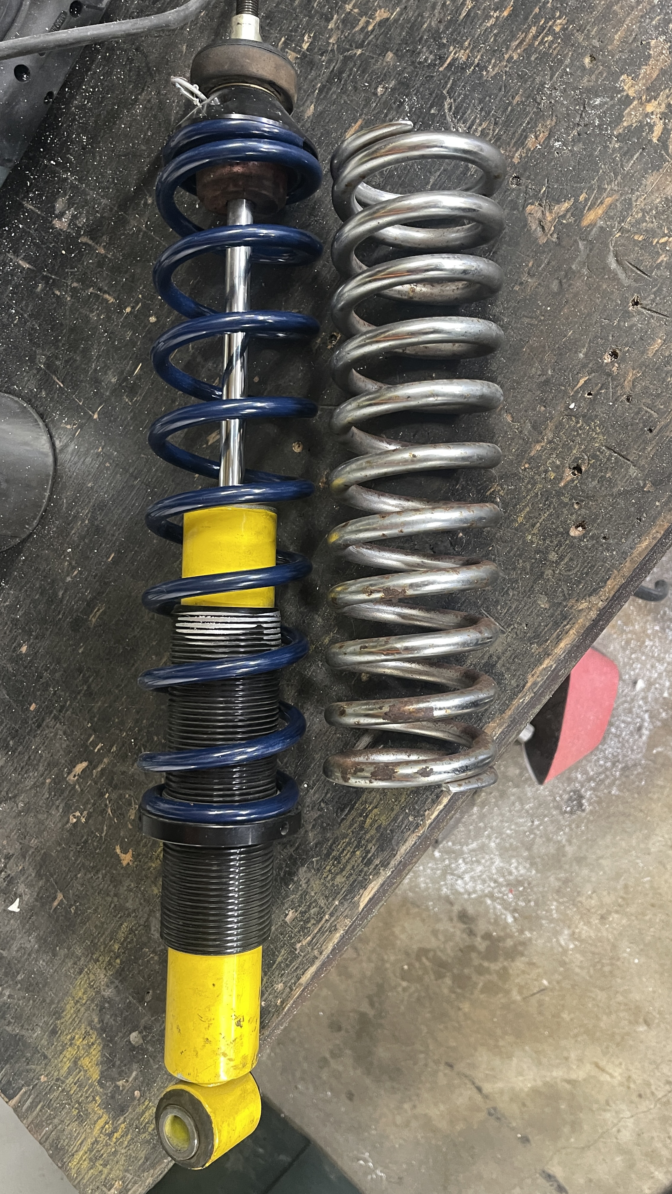

I got the rear springs in yesterday. Massive improvement. For starters the 14" 125# springs don't have any free droop so they don't rattle on the perches, and 125# is a pretty good sport street spring rate. The car came with nice Bilsteins that I never knew were nice because the suspension didn't move.
Here's a pic of the old spring vs the new spring and a link to the springs I used.
https://www.summitracing.com/parts/STR-SP14125A
