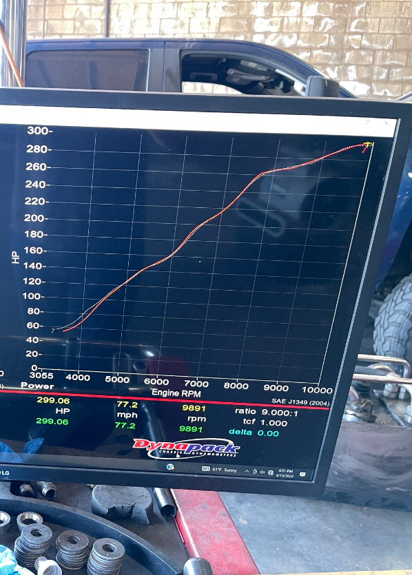

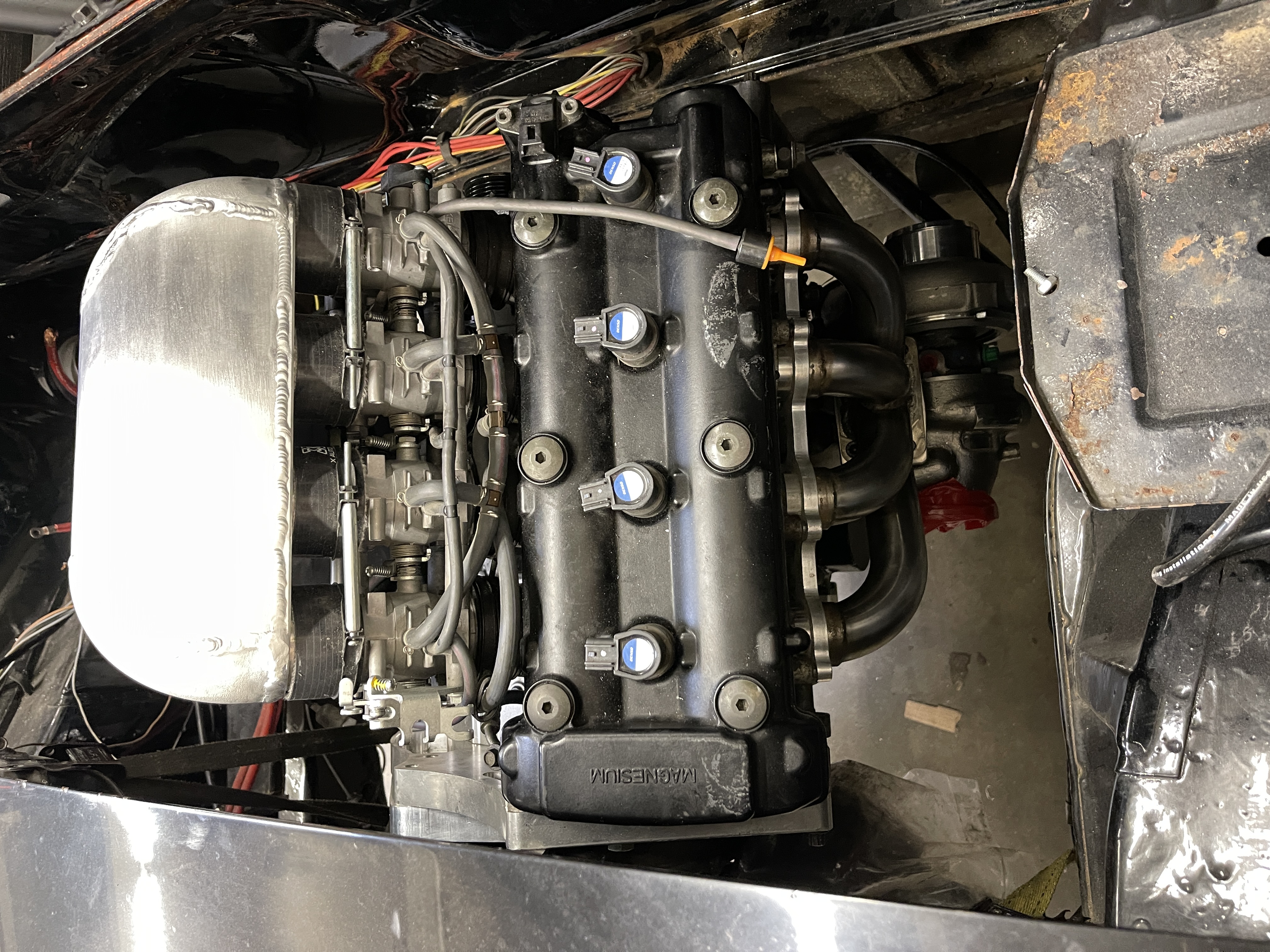

I didn't take a lot of photos of the build process, just because that can become a full time job, but I do have a few just as a teaser. I'll actually take real pics of the whole thing soon. It's a really complicated thing lol.
The second photo says a lot I think.
