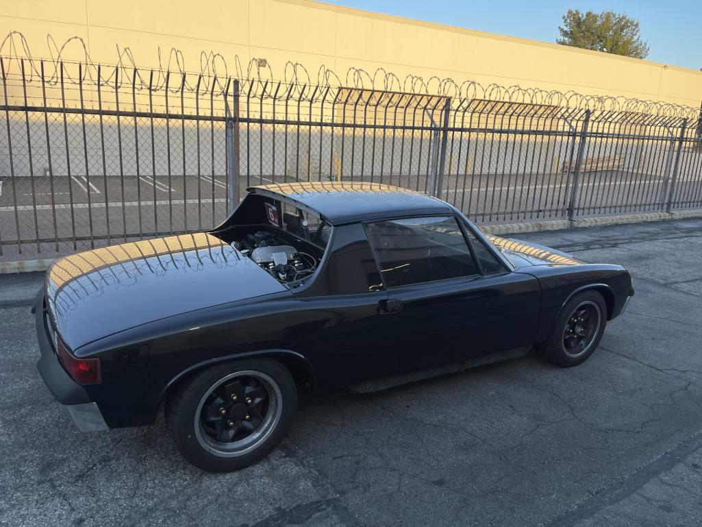

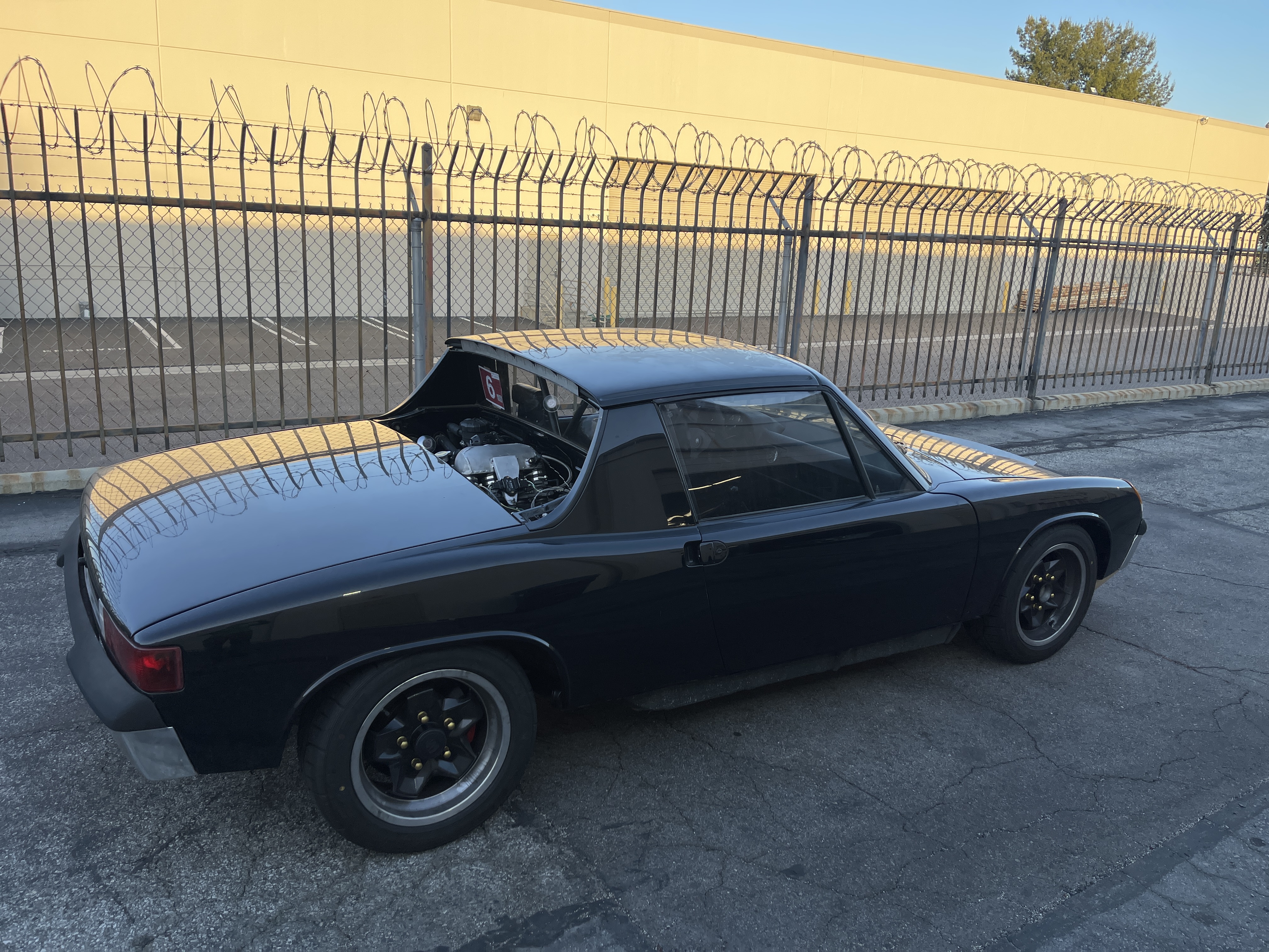

technicalninja   I just love the murdered out black car look! ...   Mar 28 2025, 06:04 PM
gnomefabtech   All that black out look was done by the P.O. but i...   Mar 30 2025, 10:43 AM
