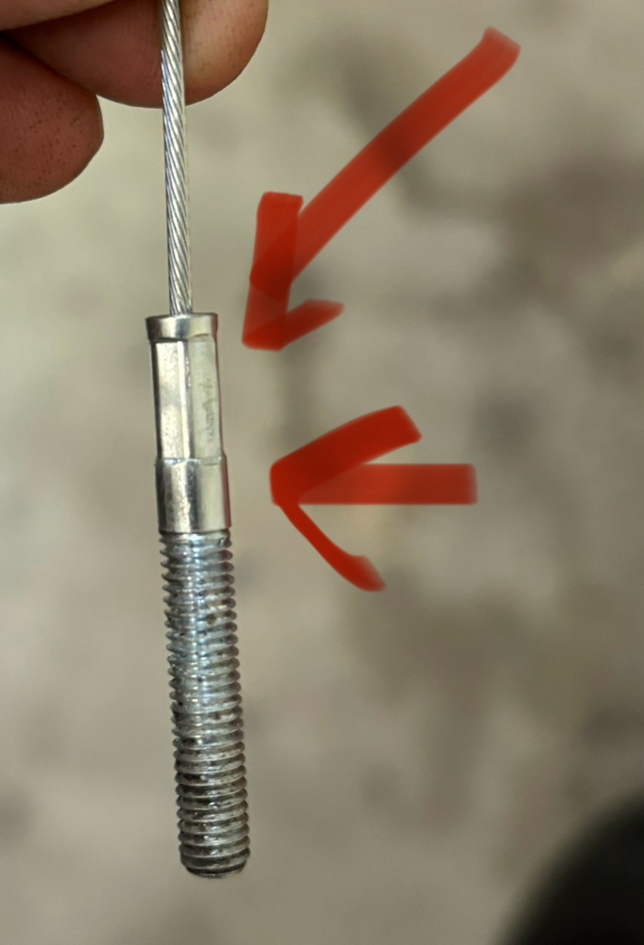

Should I try very minimally shaving/grinding a bit of material off these areas?

Tdskip   Thanks for all of the replies and attempts to help...   Mar 26 2025, 12:44 PM
Tdskip   Should I try very minimally shaving/grinding a bit...   Mar 26 2025, 12:51 PM

Tdskip   OK - got it! In the end it was the tube being...   Mar 26 2025, 01:08 PM
