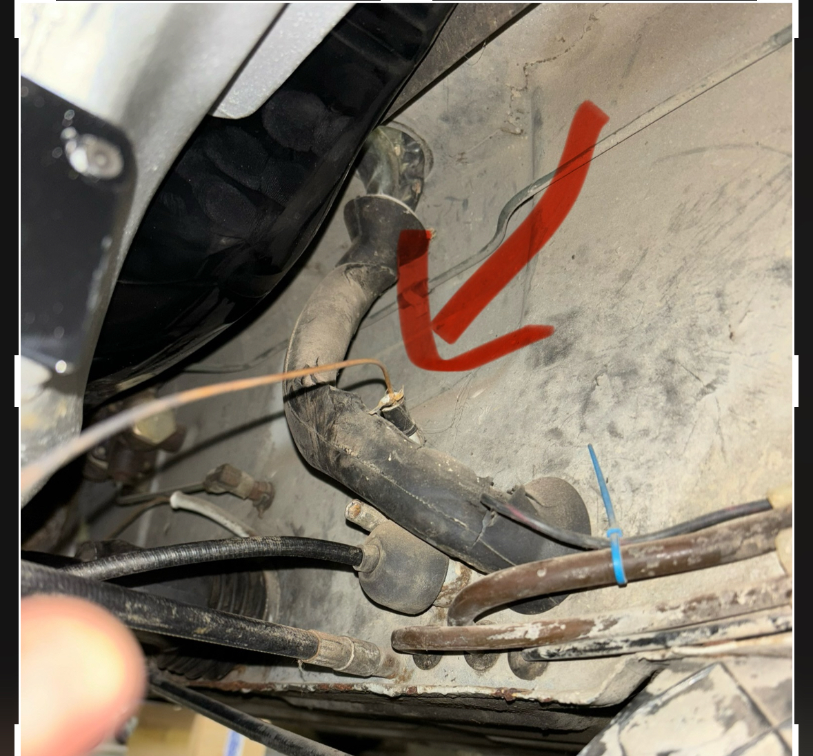

OK, once more with feeling….
This is the 74 that had the misrouted accelerator cable. That has been removed so now I have what I believe is the original accelerator cable, the arrow is pointing at it, which is good in stock in the tunnel.
Even with vice grips on it, I can’t pull it out and it doesn’t really wanna move forward either.
I’m going to have to remove this before I install replacement cable so any ideas or suggestions?

ClayPerrine   That's not the hole for the accelerator cable....   Feb 10 2025, 02:19 PM
Craigers17   Disregard based on Clay’s answer.   Feb 10 2025, 02:21 PM
ClayPerrine   And I will add that is definitely not the throttle...   Feb 10 2025, 02:25 PM
Tdskip   Oh man? This poor car and somewhat clueless curren...   Feb 10 2025, 02:35 PM
ClayPerrine   Oh man? This poor car and somewhat clueless curre...   Feb 10 2025, 03:59 PM

Tdskip   The replacement accelerator cable won’t fit into...   Feb 10 2025, 03:09 PM
BillC   The replacement accelerator cable won’t fit int...   Feb 11 2025, 01:22 PM
Tdskip   Seems like the same of seething is still stuck in ...   Feb 10 2025, 03:11 PM

rjames   I can't remember how long the tube from the fi...   Feb 10 2025, 05:05 PM
Tdskip   Thanks Robert. I’m sure there will be other issu...   Feb 10 2025, 06:13 PM

Dave_Darling   Photos of what is inside the tunnel can be found h...   Feb 10 2025, 07:44 PM
rjames   Photos of what is inside the tunnel can be found ...   Feb 10 2025, 09:23 PM
aturboman   I ran into the same issue once on a car that sat f...   Feb 11 2025, 10:41 AM
Tdskip   Oh wow, good catch. I really appreciate the time y...   Feb 11 2025, 06:32 PM
Tdskip   OK - One step forward,one step on hold. Removed t...   Feb 13 2025, 02:16 PM
sixnotfour   Slide a Phillips screw driver and wooble it around...   Feb 13 2025, 04:19 PM

Tdskip   Philips head wobble technique didn’t work (or at...   Mar 23 2025, 11:32 AM
Superhawk996   Should I get power to the drill bit to see if I ...   Mar 23 2025, 12:05 PM
Tdskip   Should I get power to the drill bit to see if I...   Mar 23 2025, 12:07 PM
Superhawk996   Be aware there is a lot of variance in how and whe...   Mar 23 2025, 12:13 PM
Tdskip   Any chance the replacement cables have larger fitt...   Mar 25 2025, 06:28 PM
Superhawk996   Any chance the replacement cables have larger fit...   Mar 26 2025, 07:31 AM

Tdskip   Thanks for all of the replies and attempts to help...   Mar 26 2025, 12:44 PM
Tdskip   Should I try very minimally shaving/grinding a bit...   Mar 26 2025, 12:51 PM

Tdskip   OK - got it! In the end it was the tube being...   Mar 26 2025, 01:08 PM
914werke   Should I try very minimally shaving/grinding a bi...   Mar 26 2025, 04:12 PM
