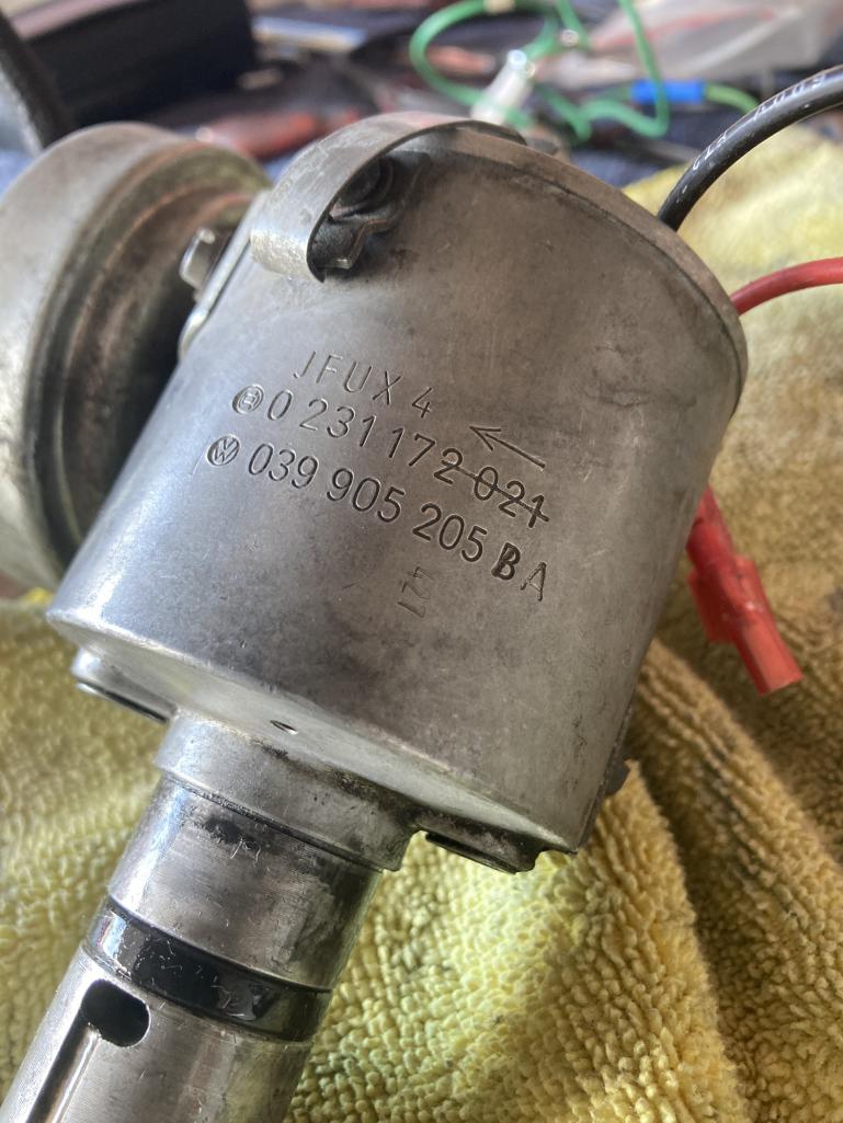

Superhawk996   Don’t sweat the distributor too much - the diffe...   Mar 24 2025, 07:46 AM
emerygt350   Don’t sweat the distributor too much - the diff...   Mar 24 2025, 08:37 AM
