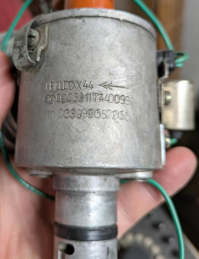

Blue Lightning   Original distributor? Yes, with a Pertronix (the...   Mar 17 2025, 11:03 AM
emerygt350   Yeah, that's a tough decision. A leak will no...   Mar 17 2025, 01:07 PM

Superhawk996   Don’t sweat the distributor too much - the diffe...   Mar 24 2025, 07:46 AM
emerygt350   Don’t sweat the distributor too much - the diff...   Mar 24 2025, 08:37 AM

Blue Lightning   Great job and this is very interesting to me ,as ...   Mar 30 2025, 10:07 AM
Superhawk996   I was an overachiever and adjusted mine to more t...   Mar 30 2025, 11:29 AM
Ron914   I was an overachiever and adjusted mine to more ...   Mar 30 2025, 11:55 AM
