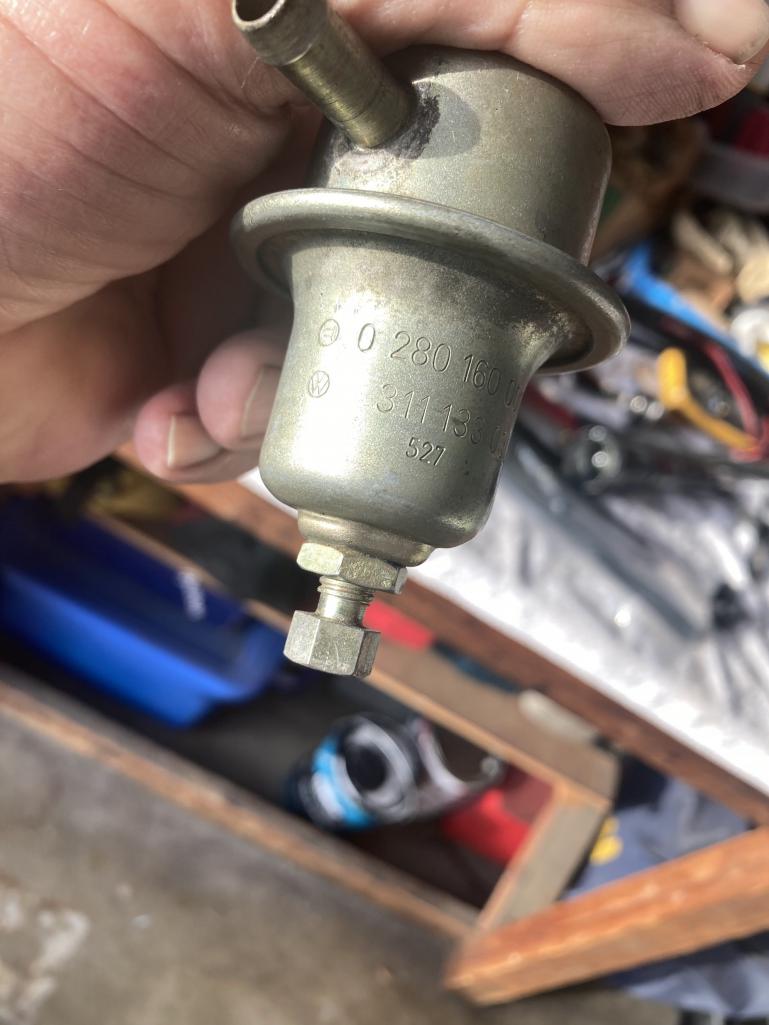

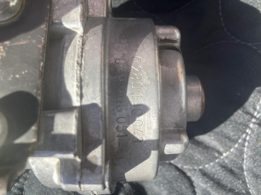

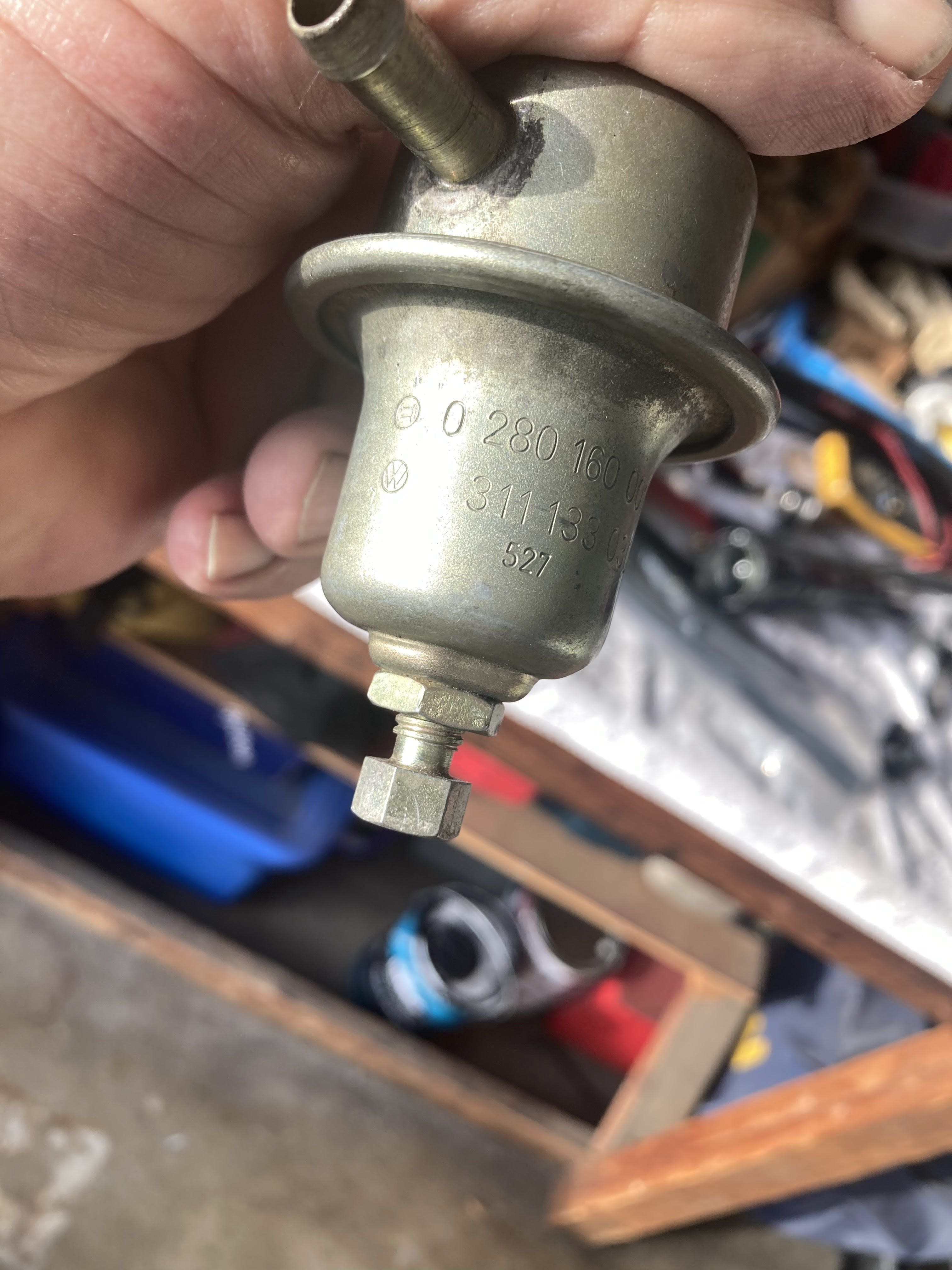

@Blue Lightning
Here are a pictures of again what I think are an original MPS and decel for reference
