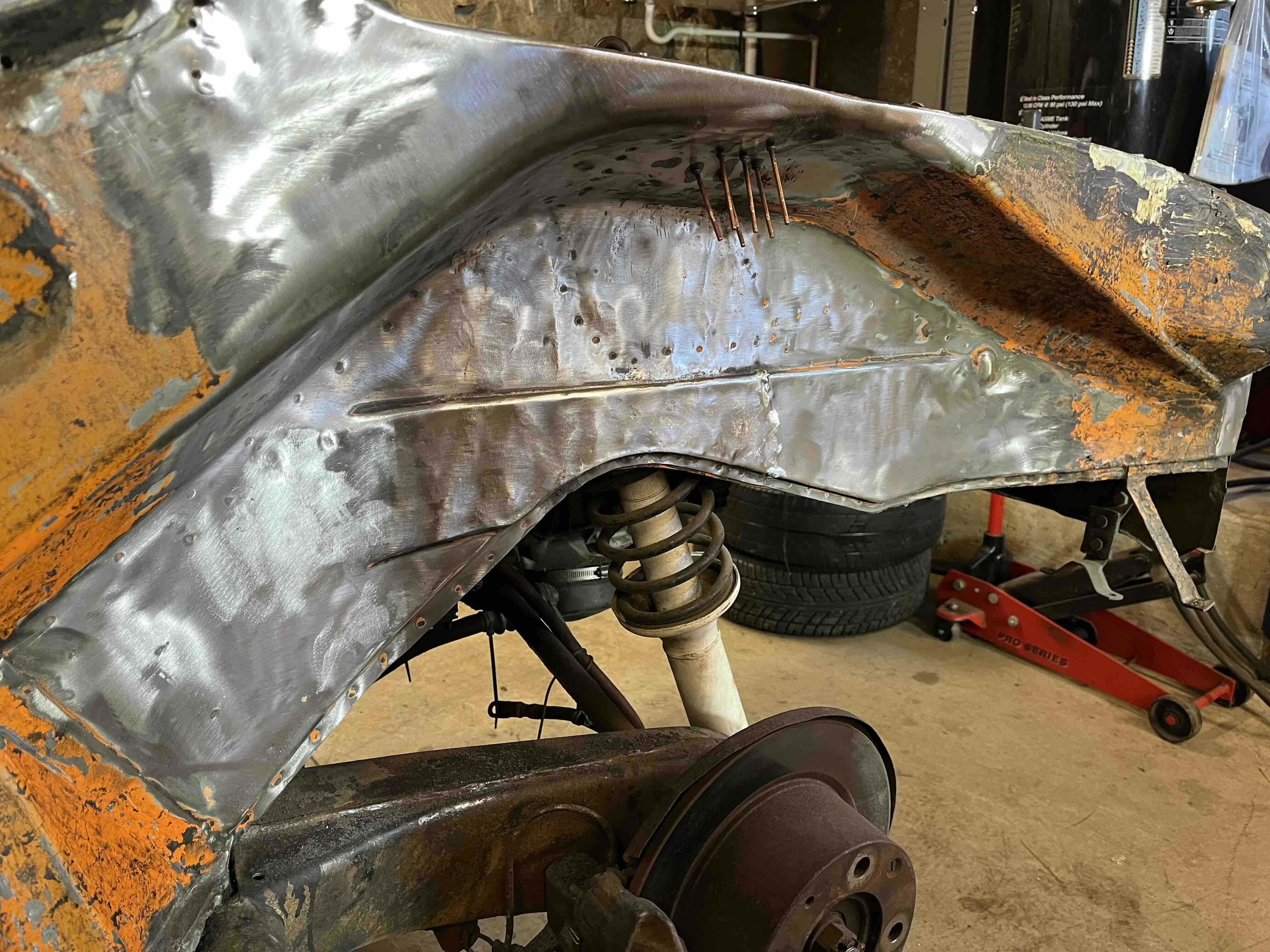

I'd appreciate advice on how to go about repairing some old collision damage from a rear LH impact that deformed the crumple zone. In the photo you may be able to make out a vertical crease that was previously straightened out just behind the rear strut and going from the bottom pinch seam up the top of the inner wheel well (maybe beyond that....still cleaning out the undercoating).
The evidence that I've found of the impact so far includes:
-The rear quarter/rear of door gap was too tight (maybe 1-2mm throughout)
-Area around the old crease is dented in several MM
-There's a lot of subtle deformation (high and low spots) between between the old crease and continuing forward of the rear strut

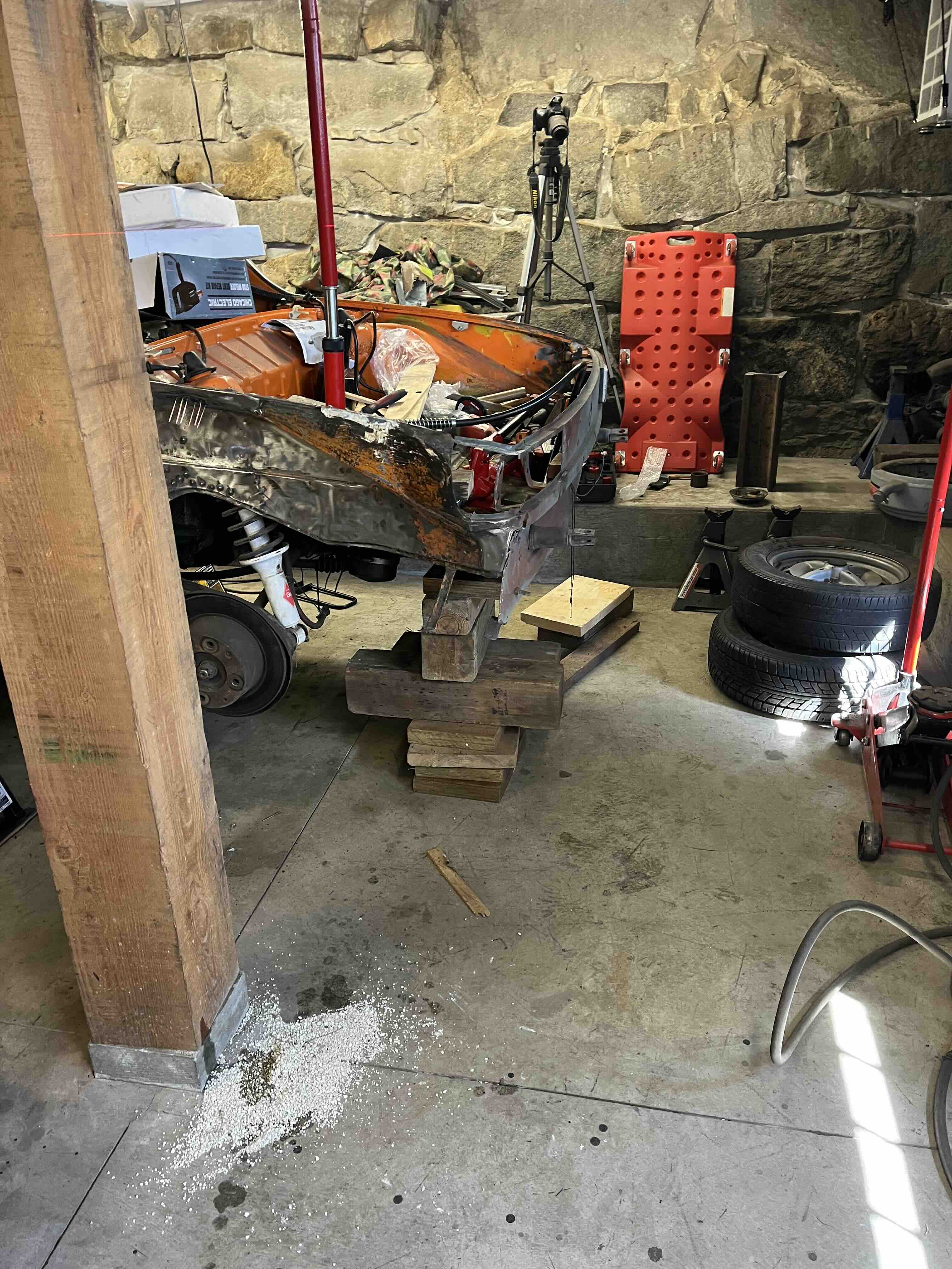

Making some decent progress straightening this out. I used a stud welder to pull out the deformation in the inner wheel well skin beginning behind the suspension console and working toward the old kink in the shock tower area.

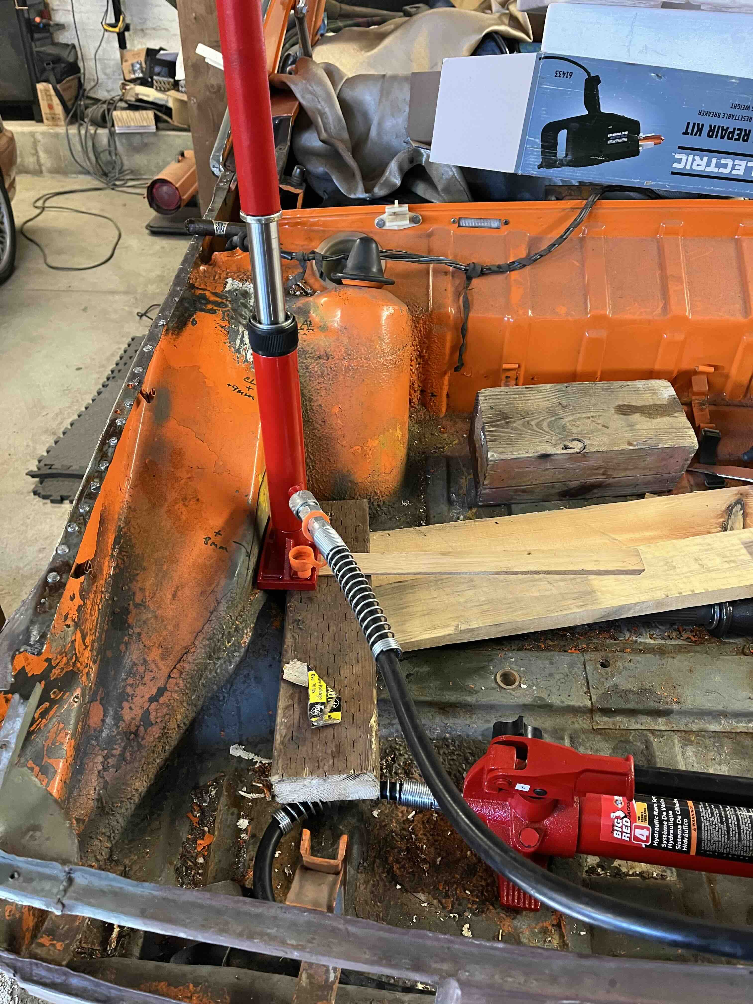

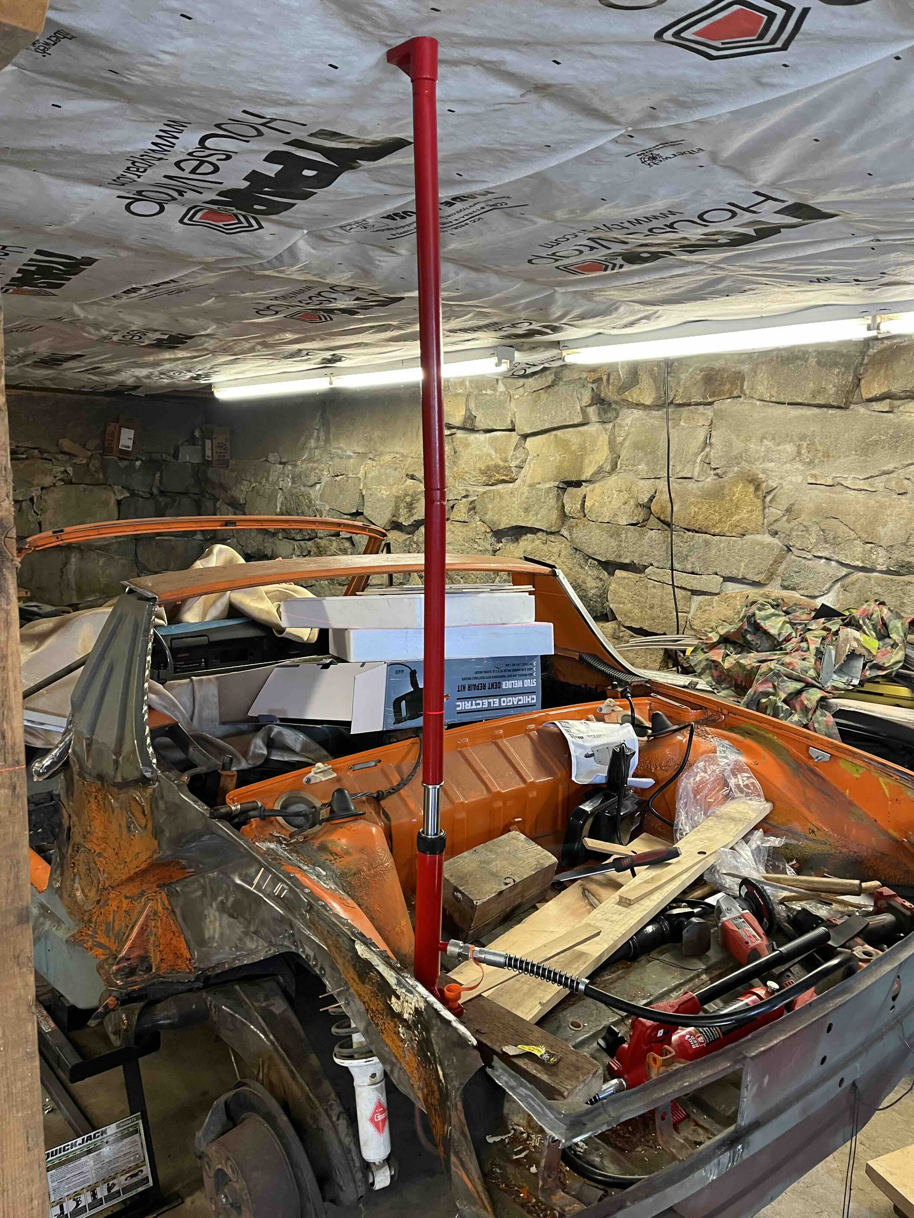

At that point I cribbed underneath the transmission so that I could use a body jack to push the LH structure downwards (it was 5mm to 9mm higher than the RH side from the old collision). I kept jacking (pushing downwards from a ceiling joist in my barn), releasing the jack, measuring, and repeating. After several iterations I got the LH to within 3-4mm of the RH side at my measurement points (using a laser level). There was much celebration.
There is still a slight (maybe 2-3mm) bulge in the bottom of the shock tower structure that I plan to push in using the body jack. Then it's on to straightening the inner wheel well skin backwards to the tail of the panel. I also need to work out the deformation in the top of the wheel arch and make sure that the mating surface for the quarter panel is level with the RH side. Hoping at that point that I'll find the replacement quarter panel-to-door gap will be correct so that I can start piecing together all of the sheet metal panels.
