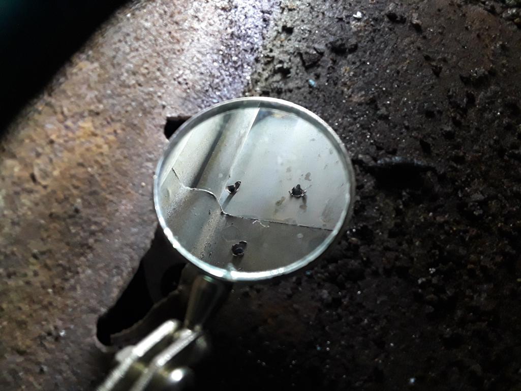

OK, once more with feeling….
This is the 74 that had the misrouted accelerator cable. That has been removed so now I have what I believe is the original accelerator cable, the arrow is pointing at it, which is good in stock in the tunnel.
Even with vice grips on it, I can’t pull it out and it doesn’t really wanna move forward either.
I’m going to have to remove this before I install replacement cable so any ideas or suggestions?

Reminded me...
Heres one. OG cable came out of the tube albeit with a tug, but new cable wouldn't go in. Sound familiar.
Tried ALL the tricks in the bag, but seemed like the cable end was hitting a wall with about 2-3" from end.
Turned out a PO's errant sheet metal screw had pierced the tube and caused enough of a intrusion that it was no longer possible to feed the
rod end through anymore (IMG:style_emoticons/default/headbang.gif)
