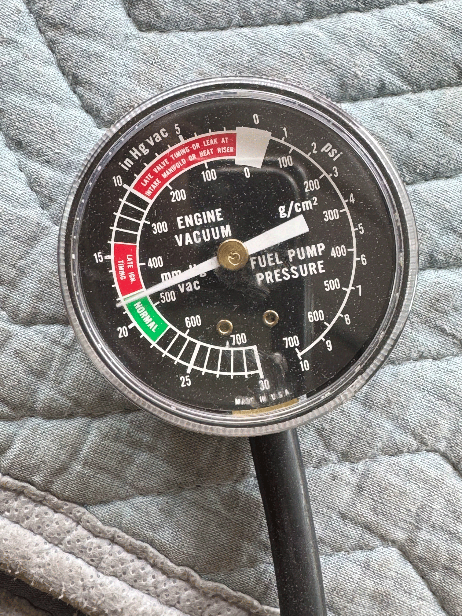

and the idle vacuum is much better and the idle adjustment screw actually has some effect! Would never have thought it would be that sensitive to something like the valve adjustment!
